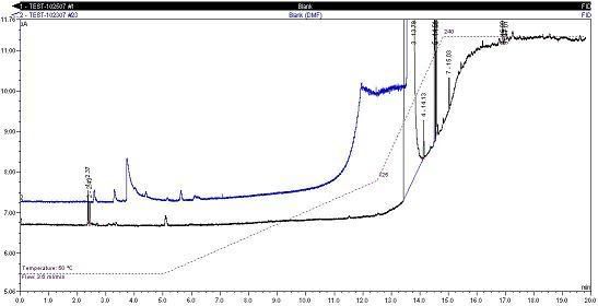

Here is an overlay of my manual injection (black) vs. the headspace injection (blue). Notice the 'peak' of concern at ~3.8 min and the large difference before the actual DMF peak (13.8 min). The early eluting peak is independent of DMF brand or purity, but dependent on introductory method.
These systems are < 6mo. old and all have the same new G1888 components. The only difference is that this system ran a few more headspace validations than the other 3 systems. I'm not sure how to clean the needle and will consult Agilent.

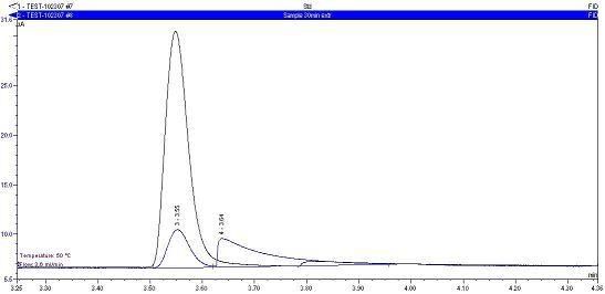

Peak in comparison the the methanol peak. This is an overlay of sample solution and a standard. The sample methanol peak (3.55 min) is much more affected by this peak.
