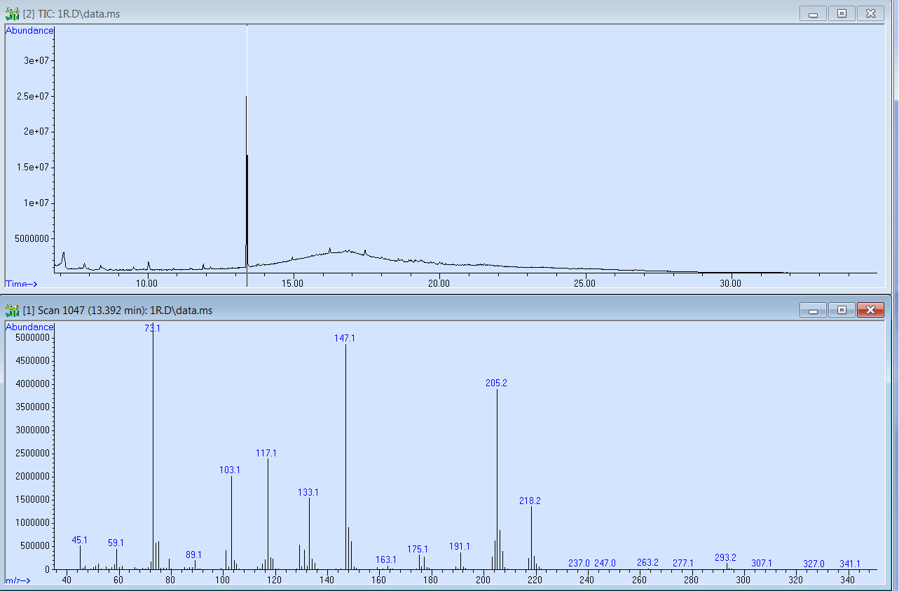

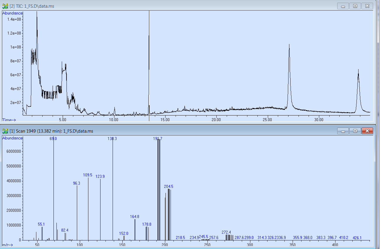

I need an advice concerning 5-year old Agilent GC-MS 7890/5975C which m/z resolution performance has changed drastically just in one night. Day before chromatogram and spectra were quite normal (peak of trimethylsilyl ether of glycerol is shown) : Image Next mornig it changed to a helpless mess: Image Another example: Image

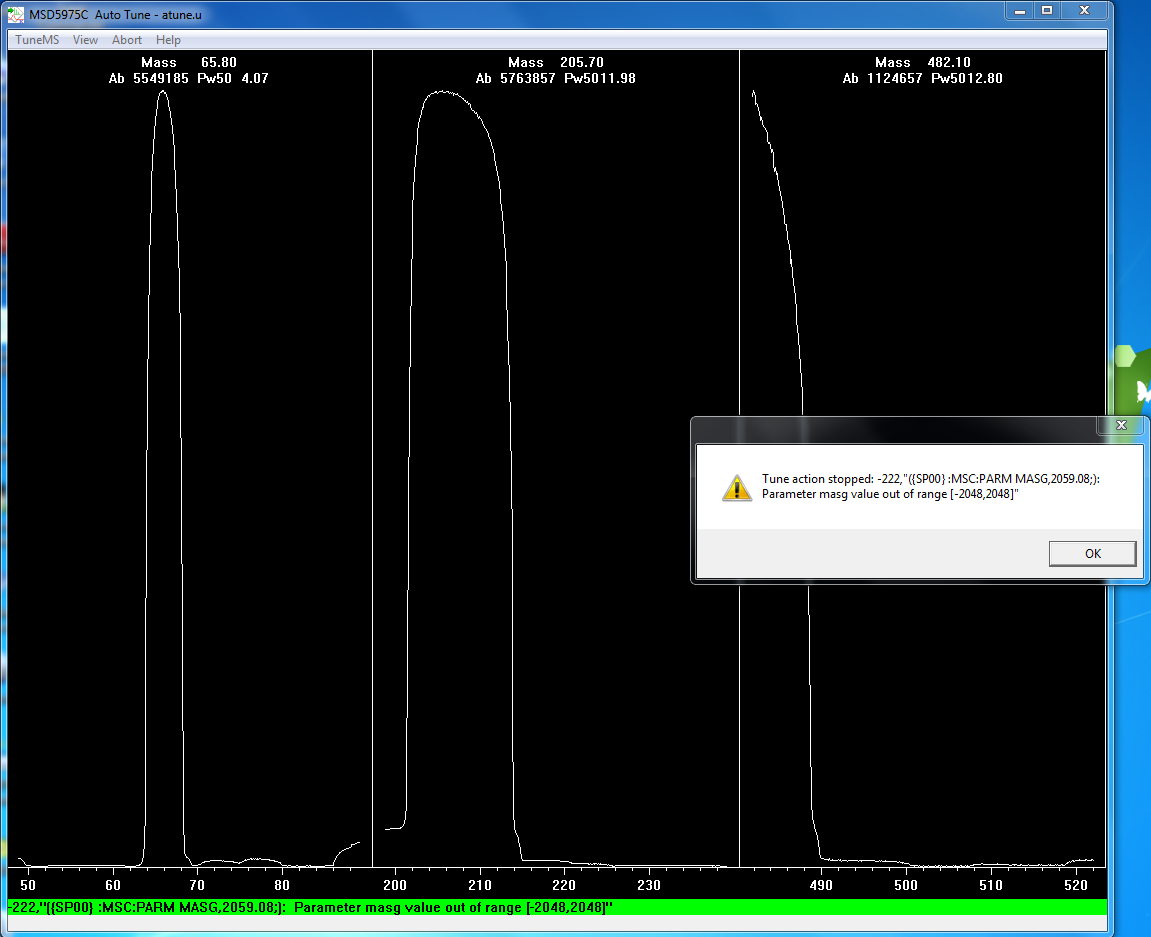

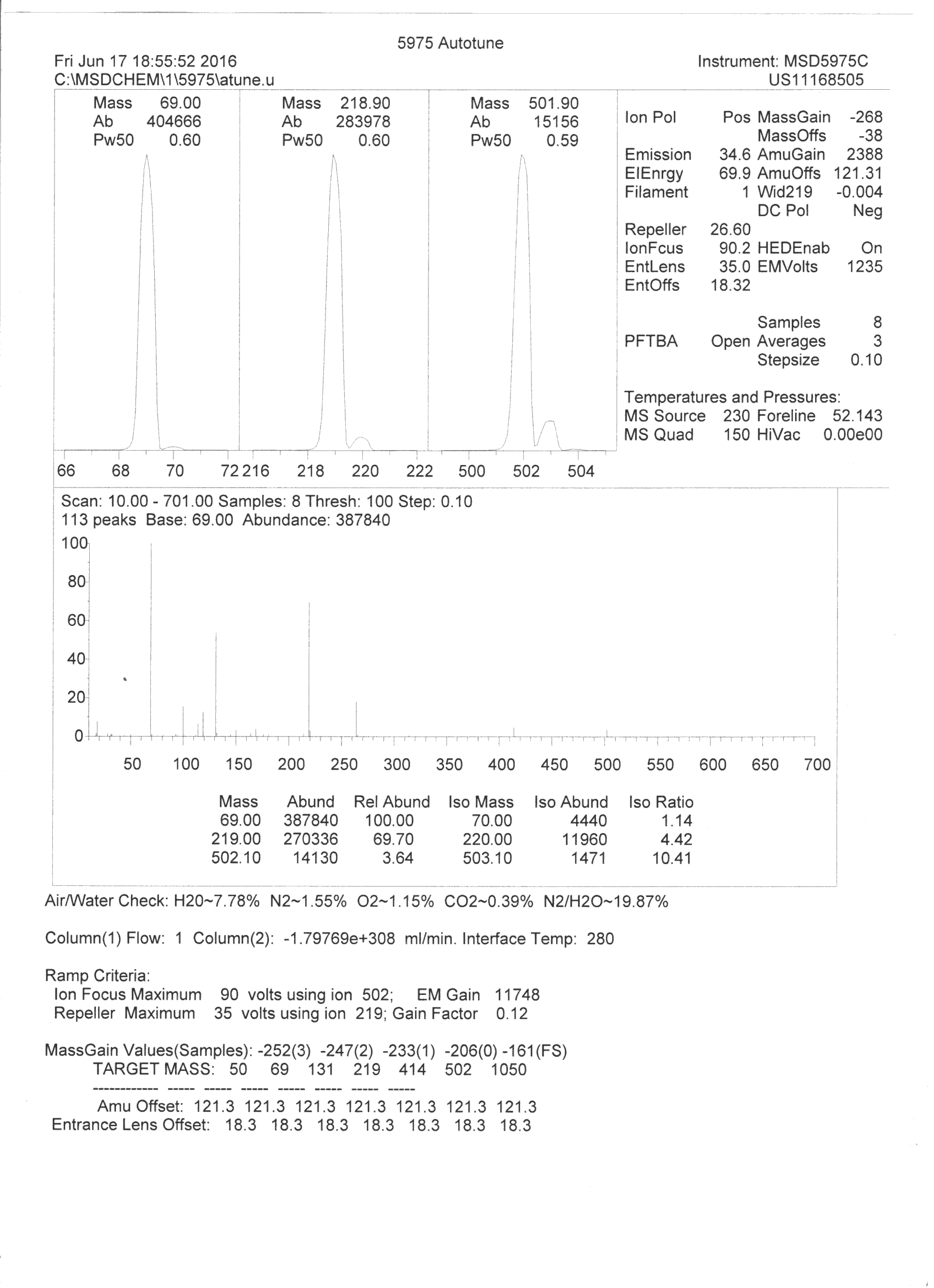

Autotune process aborted with the error:Image Last successful tune was performed June 17th Image
It could be noticed that the greater m/z, the poorer the resolution. Also, mass shift occurs and m/z assignment now incorrect.
