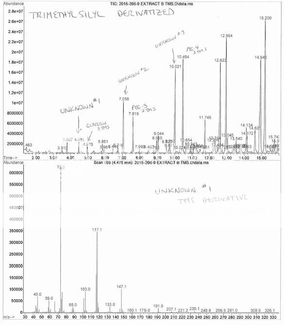

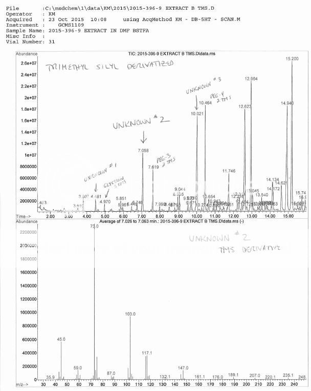

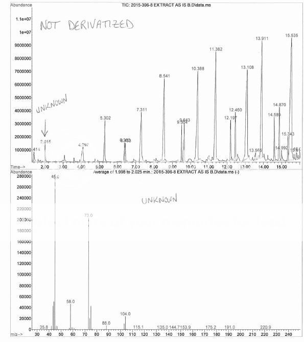

I need some help figuring out an identity from EI spectrum of unknown components in polyethylene glycol samples. I have a homogolous series in some polyethylene glycol materials, this series has a similar but different mass spectrum and retention times than the actual polyethylene glycol peaks, whether injected as is or as trimethylsilyl derivatives. The unknown series also gets derivatized, but I'm not sure if it takes 2TMS like the PEG series, or just one TMS. I'm posting the chromatograms and mass spectra of some of the smaller MW components, maybe someone here is real good at determining structure from these and can help me. Four attachments, first two are derivatized. I think once we figure out one of what we have, then the rest will fall into place. The samples should contain only carbon, hydrogen, and oxygen, and ethylene oxide is reacted (conditions unknown) to form the PEG. Thanks in advance for any help.

If we make some assumptions that
1. The underivatised spectrum does not have the background subtracted
2. The disappearance of the unknown peak is due to silylation
3. That ion 104 is the molecular ion
Then apply the following reasoning
1. The molecule contains one of the following functional groups that can be silylated
a. SH - I will discount that on the grounds of unlikely given the context - and because I can :D
b. NH - I will discount because that would give an odd numbered molecular ion unless there were an even number of amine groups and because the peak does not appear to tail, which is what I would expect on a non-polar column.
c. a COOH, which again I will discount because of a lack tailing on a nonpolar column and lack of ion 60 and the NIST library would have all of those anyway
d. A single trimethyl silyl addition should show a peak in the derivatised sample with a molecular ion of 176 (or 248 if 2 TMS groups are added) - somebody please check my maths.
e. an OH group - hmmm
So assuming an OH (gulp)
I am drawn to an empirical formula of C5H12O2
I have tried various combinations of glycols and glycol ethers but can't get the right fragments or MW
However, thinking about the manufacturing process with ethylene oxide I am drawn towards ethoxylated propanol/ipa CH3-CH2-CH2-O-CH2-CH2-OH. The fragments would be consistent (interesting that TMS would also give a 73 ion but that may be a red herring)
The peak with the 102 ion could be the unsaturated version but I would expect it to elute earlier than the 104 MW on a non polar column?

The best MW = 104 that I can see with this sort of fragmentation pattern is:
HOCH2CH(CH3)OCH2CH3 (C5H12O2)
It's a monoethylether of propylene glycol. I read in McClafferty's book that primary alcohols tend to give a pretty good MW-18 (in this case 86). This molecule fits the bill in that sense as well.
Unfortunately, the dipropylene glycol analog with the ethyl ether on one end and a primary alcohol group on the other end (C8H18O3) is not in the NIST database that's online. The one that shows the secondary alcohol on one end is there but the fragmentation pattern doesn't match underivatized unknown #2.

I think that there are some clues here from m/z values that are (A) seen as well as those that (B) are not seen.
(A) IF the MW of underivatized is 104, then m/z 103 is characteristic of loss of H from aldehyde.
(B) My recollection of TMS ethers is that the molecular ion region is usually characterized by BOTH M+. and [M+. - Me.]+, but I cannot see any such pairs. Would expect to see m/z 176 & 161 for a mono-TMS ether of MW 104.
Suggest CH2(OH)CH2CH2OCH=O ????? if MW 104 is true.
At the end of the day, it all rides on knowing the MW's unequivocally.
[EDIT: I would really like to see spectra summed across the chromatographic peak with some background subtraction !!]

TMS derivatives of primary aliphatic alcohols show ion current at m/z 73, 75, 89, and 103. TMS derivatives of secondary aliphatic alcohols show ion current at m/z 73 and 75 as well as m/z values due to the substitution on the carbinol carbon. In the the case of these two spectra, this would be the peaks at m/z 103 (89 + 14 = R(CH3)COH) and m/z 117 (103 + 14, ibid).
Both spectra of the TMS derivative exhibit ion current at m/z 147 ((CH3)2Si=OSi(CH3)3). This indicates that more than one group has been derivatized such as a vic di-ol (like whould be the case in the spectrum of a TMS derivative of ethylene glycol or as in the case where to derivatizable groups are located on a chain so that the gas phase molecular ion can fold to the point that the two groups are adjacent to one another as is the case with 1,10-decanediol). Both spectra also show some ion current at m/z 89 (not much, but some); therefore, there could be one methyl substitution and one primary alcohol group.
The non-derivatized spectrum of Unknown 2 (5.302 min) exhibits ion current at m/z 102, which could represent the odd-electron ion [M - H20] (m/z 120).
I think both spectra are secondary alcohols with two OH groups, where one or both have a CH3 on the carbonol carbon(s).
