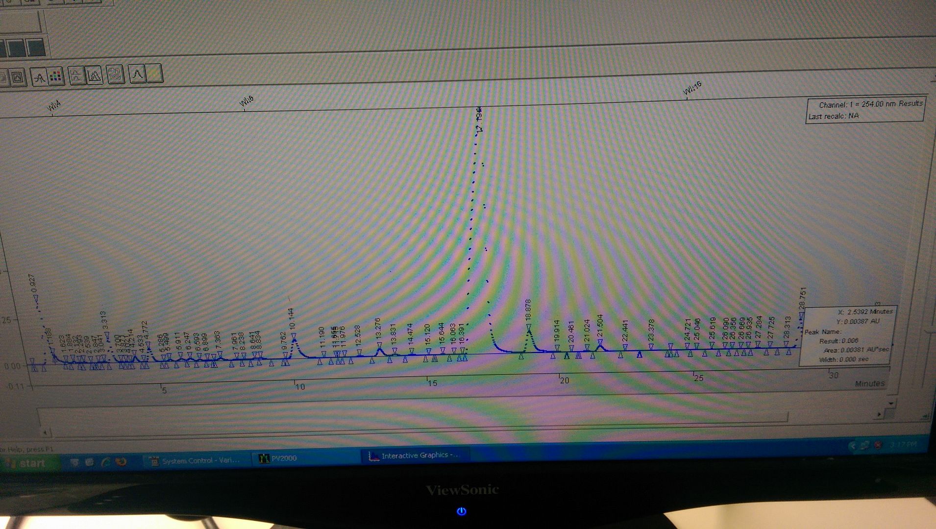

Initially, I tried using plain unbuffered MeOH:H2O. From 70:30 MeOH:H20 to 95:5 MeOH:H2O over 25min. The peak shape of the main component looked nice, however there was an uneven baseline due to gradient drift and several other components did not resolve well. Here is how it looked...

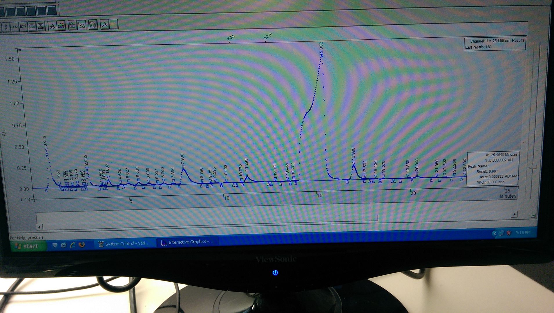

After reading up on some literature, I changed the solvent system to 35mM ammonium formate at pH 5.5. This time the baseline was beautiful, and most of the peaks gave sharp and great definition (some tailing). However the main component now shoulders...

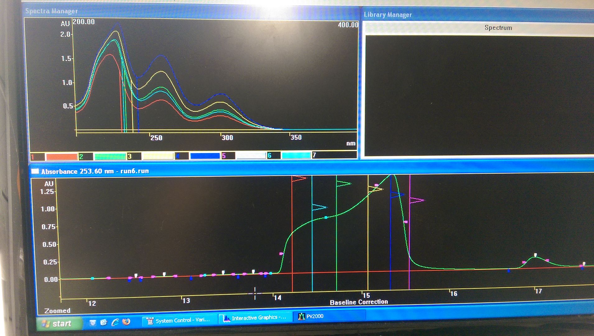

5. The most obvious reason would be a co-eluted peak, however the purity factor on the DAD revealed the peak was pure, and scanning the UV of the peak across its whole width showed a similar absorbance...

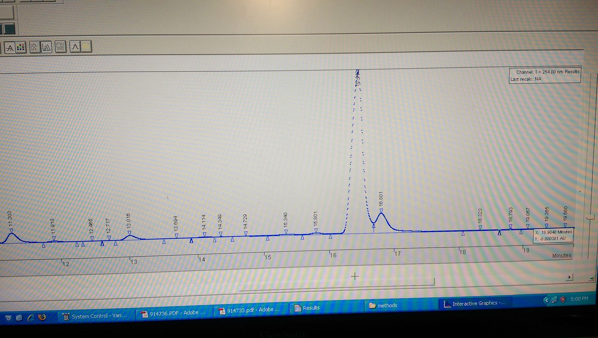

So I've been doing some tinkering. Changed the pH of the aq. buffer to 5.1 and now look at the difference...
The shoulder is definitely gone. Peak still a little mis-shapen, but I'm going to adjust the pH to 4.5-5.0 range and see if that resolves this last little issue. Must be due to a column interaction, probably silanol hydrogen bonding. The 0.4 decrease in pH must have been enough to protonate everything. It always amazes me to see such a small change in pH can have such a dramatic effect.
