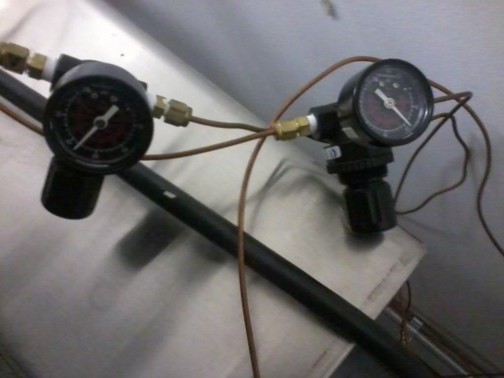

On the back of my Series II, there are 2 swage-nut fittings for the inlet gases. I put a tee in my helium line to feed both injectors:
http://i1285.photobucket.com/albums/a59 ... bafe92.jpg
I put an extra tee in the line to feed the makeup gas (I use helium for that as well). One helium tank feeds it all for multiple GC's in my lab. The makeup gas control is a needle valve (see the set screw inside the knob on the front of the instrument). You adjust it with a screwdriver and set the flow how you want it. Chemstation should allow you to adjust the head pressure on your columns.
I have one air and hydrogen cylinder that feeds the FID's in my lab. So, I use these inexpensive single-stage regulators (I think I got these from Restek) to step the pressure down and adjust the flows to the detector(s) from the main 2-stage regulators on my tanks.
http://i1285.photobucket.com/albums/a59 ... 697e50.jpg
I have been doing it for years and haven't had any trouble. The FID support gas connections are made through the side door of the instrument and go into the on/off valves on the front of the instrument.
For a flame detector, the cleanliness of your gas will have a direct bearing on your sensitivity. Bad gas will give lots of noise. If you don't need "gnat's hind end" sensitivity, then the air won't matter too much. If you want a quiet baseline, the cleaner the air the better.
