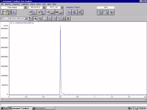

What they are saying is possible. I cranked up the pressure on one of my GC's and injected methane (30 m x 0.53 mm x 1.0 µm wax column, helium carrier gas). The flow calculator says the RT should be 0.604 minutes. Here's what I measure:
For H2, 8.5 psig on the same column should yield a time for unretained of about 0.3 minutes.

OK, now show me a peak eluting in 0.4 sec ! which is what is in the OP. :roll:
Got me there. I overlooked that and figured they meant 0.4 minutes.
