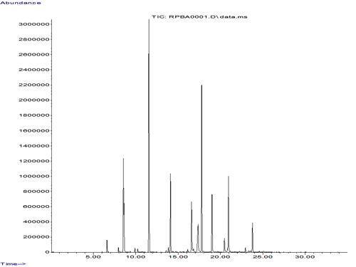

I do this sort of thing all the time, with the fiber you describe. It's my fiber of choice actually.
Would you append an example of your poor chromatography? Here's mine. I don't need to see ethanol and I do acetaldehyde another way if needed so I only scan to m/z = 50. That's why there's no EtOH in the chromatogram. (Column is Rtx-5, 60 m x 0.32 mm x 0.25 µm from Restek).

Wax is better but this just happened to be a 5. The point is that the SPME fiber should be ok for the application.
