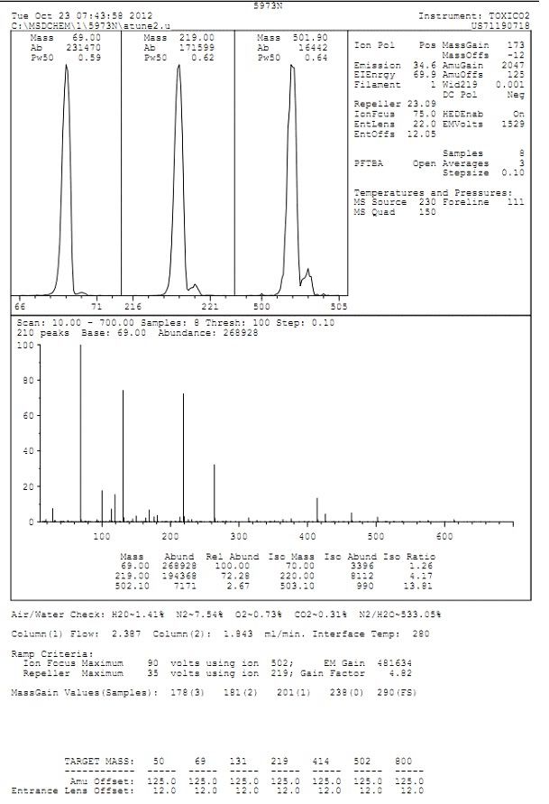

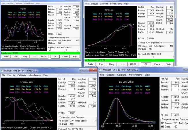

I am working with a GC/MS Agilent 6890-5973 and I have problems with the optimisation of the repeller and the entrance lens in the manual tuning (problem occured after source maintenance). I can't get the Gaussian shape that I should have normally (see picture below).
This problem also occurs in the atune.u mode although the Tune report is fine (parameters are ok, abundances are ok...). I would have started my analysis if it wasn't that I was in front of the screen when the tune was running and I saw quickly that the repeller did not give a Gaussian shape..

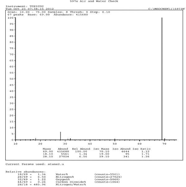

You have already verified that the source is good by installing it another MS and getting the good tunes and installing the other instrument's source in this MS and getting bad tunes. Now you know it's not a corrupt tune file. Please post you're air/H2O check and a profile and scan of you're manual tune (69,219,502).
Hello and thanks for the help, here are the air/H2O check and the manual tune
Hi!
You have a air leak....correct it.
Air/H2O and peak shape look good. If you find bypassing the EZ no vent works out by installing the column directly, it may be a cracked or broken transferline on the EZ no vent or it may be inserted too far into the MS source. Great trouble shooting technique!
