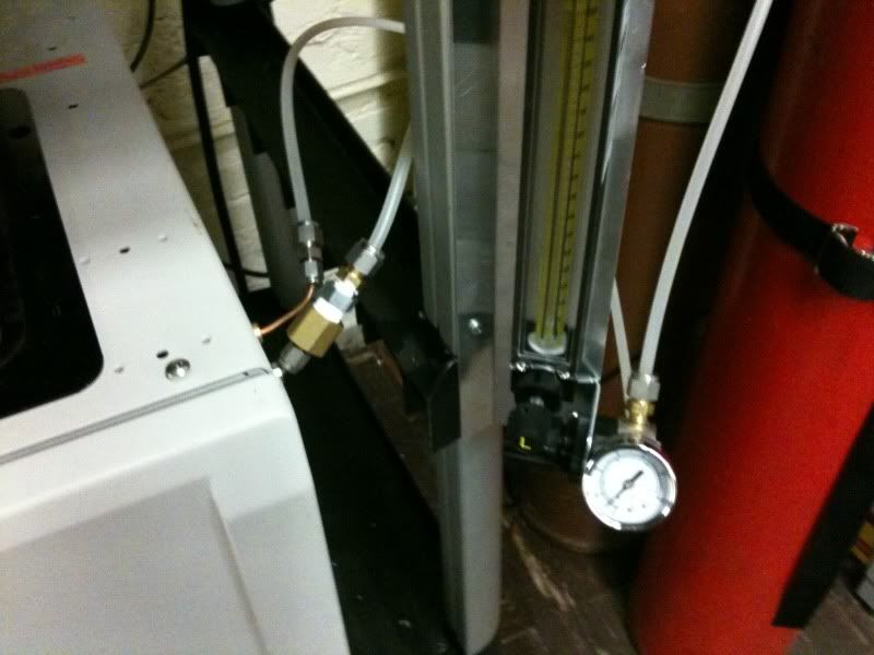

I use a miniature regulator to monitor the pressure of the incoming sample gas at the inlet and a rotameter to monitor the flow at the outlet. I have included at snapshot of the setup below.

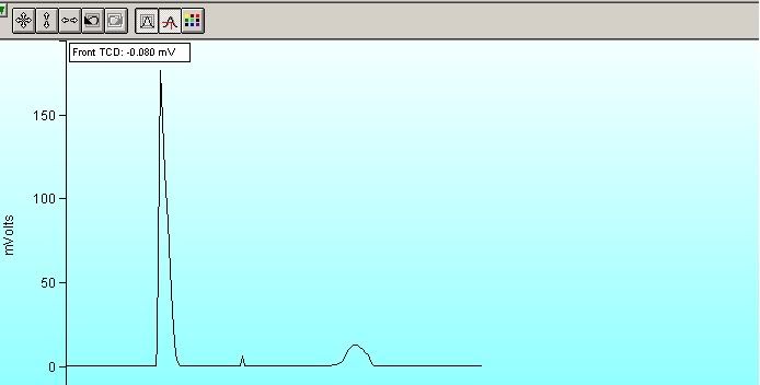

The way I have been instructed to do this (by someone who is only slightly more qualified than me) is to first calibrate the method by injecting a sample and taking note of the retention times. I then put these retention times into the 'peak table' of the method along with the gas names and their respective percentages. I then run the method as 'type calibration'. I then run the method again as a 'type analysis' and the result is the following image:
As you can see, there is a small peak that should not be there (I think). The N2 is on the left and the CO2 to the right. I have run this method about 7-8 times in an attempt to 'flush out' whatever that peak is. The area counts for this peaks have dropped with each run but they are taking longer and longer to reduce now (we are around 3500 counts now). Moreover, my results are a bit off. It is reporting ~85% N2 and ~15% CO2 instead of 86/14 and I think that the stray peak is what is causing this.

It's been a loooong time since I did GC, but a few observations:
1. Assuming you are using a thermal conductivity detector, different compounds have different response factors so that 86:14 composition will not necessarily give 86% / 14% peak areas. You need to validate the method by running different standards at different ratios in order to determine the relative response factors.
2. GC columns and detectors have a limited range. Overloading the detector will tend to give "flat-top" peaks and (obviously) incorrect results. Overloading the column will tend to give tailing or otherwise distorted peaks. A quick look at your chromatogram suggests that you may be overloading the column.
3. Interfering peaks are common. They can come from things like residual oil in gas cylinders. They can be a tremendous pain to clean out. As long as they don't overlap with a peak of interest, it's probably best to handle them the "old-fashioned" way (ignore them!).
4. As long as you have a good separation, small variations in the way you read the retention time should not be a problem.

I am curious about the nature of the column you are using.
The two 'sharp' peaks might both be N2 from the valve switching. And the broad 'doublet' might be CO2 and water coeluting. If the second sharp peak is separated in time for the same time the valve is held in an inject position before returning to the load position, then you have a 'reasonable' double sample injection, the first from the large volume sample loop and the second from the dead volume in the opposite side of the switching valve.
Too little information to be sure, but something perhaps you can check out.

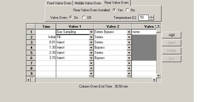

Hello Rod! :D Thank you for your input. I don't really understand enough about how this machine works to fully understand your post, but I think I might be getting the basic idea. Is this part of method at all helpful?
I am just using what was given to me, so I have no idea why those times are meaningful (I actually doubt that they are meaningful outside of the scope of whatever that person was doing with gases at the time) or what series and bypass mean.
Also, here's another important question I have: How should I be controlling the pressure/flow of my sample gas? As you see from the image in the 1st post, I have a regulator at the inlet and a rota meter at the outlet. Is this typical? To me it makes more sense to have the rotameter AND the regulator at the inlet. What good is monitoring the outlet flow? Especially since it changes when I inject the sample?

I don't understand what you are doing unfortunately from the info you have provided.
Try to learn what this information means that you have provided.
It appears that you are doing two injections, one with a column in series and the second with the column removed from the flow path (bypass).
The little peak might be an flow upset from the valve operating.
The retention times are determined from the tops of the peaks.
The meter shows that you are getting sample through the sample flow path (you are not out of gas).
The flow should be zero when you are ready to inject (sample is under ambient pressure).
