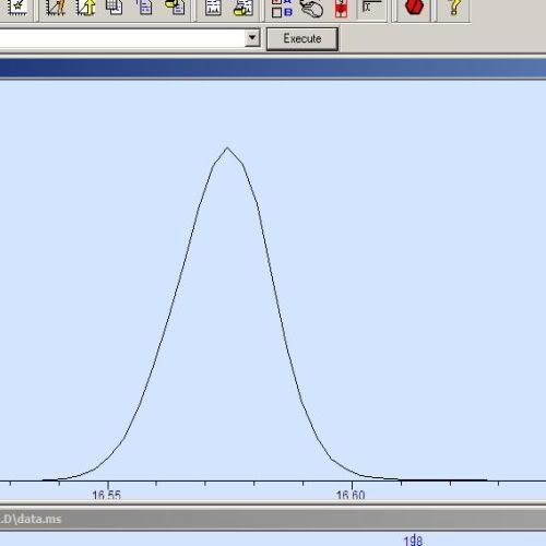

Zoomed view of portion of Simdata:
..and same standard injected right after:
Christian

How far apart are the two apices of the split peaks ?

Is the area of a good peak the same as the total area of a split peak ?
2.4million on split peak, 2.6million on good peak. area seems consistent.
