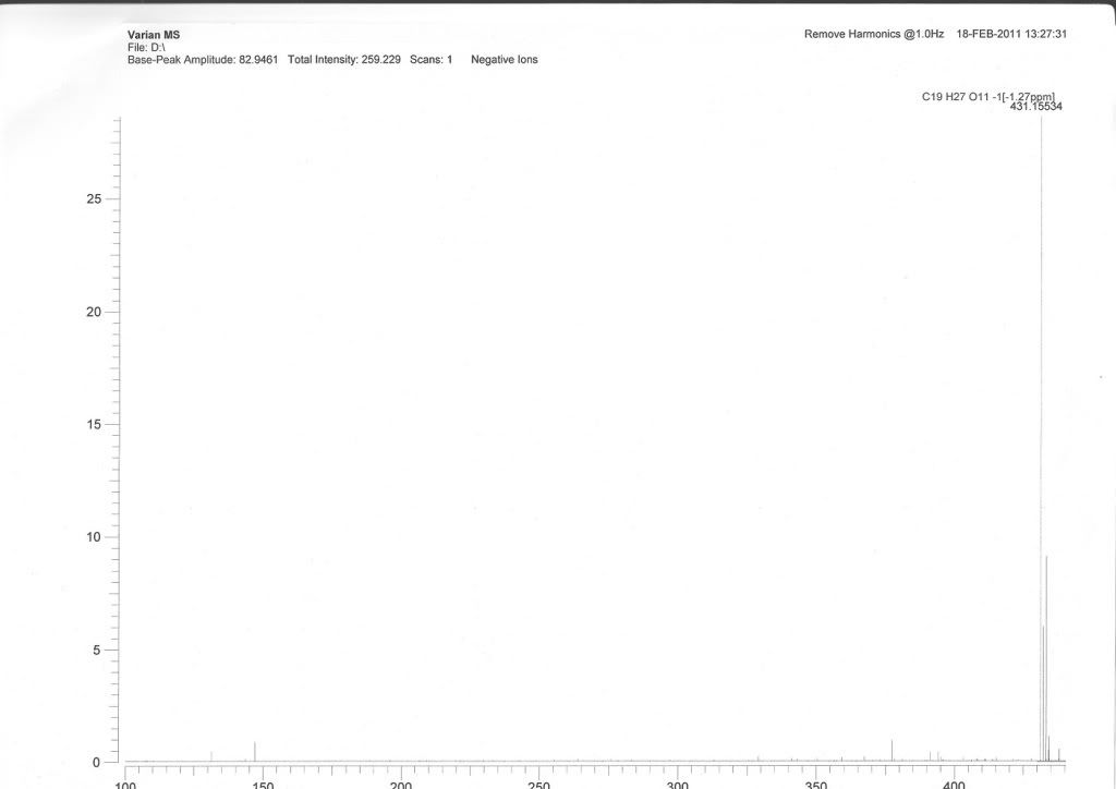

Although there is an isotop ion peak but I don't think the [M+Cl]+ since the calcd [M+Cl] 431.11089 is to far from the found value 431.15534. My compound is C19H24O9, and this is the ESI-MS spectrum in negative mode:

Looks like you have an M+2 peak that is about the right size expected for Cl.
What is the mass of that peak?

yup, you've got a problem: you've got a +2 peak that's the right size for chlorine, but you've got the right mass for addition of two water molecules. Like Alp, I'd also check the calibration before going any further.
