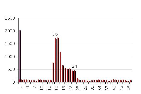

Here is an example of what I'm referring to. The is a C4 4.6 mm ID column with CH3CN + 0.1% HFBA in the mobile phase.
Gradient:
5-30% CH3CN over 5 min
30-50% CH3CN over 60 min
1.5 minute fractions collected
