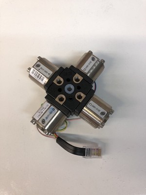

By the way, when using refractive index, we always matched the detector temperature to the column temperature. And bypassed the Agilent multi-channel mixing valve with the little adapter.

Can you please elaborate on what part the Agilent multi-channel mixing valve is and what little adapter you reference?
Your system cannot be UPLC because of the column sizes you detailed; Agilent 1260 is new since I've retired. Traditional Agilent quaternary pumps had a multi-channel mixing valve and binary pumps did not. Here's a photo of the adapter (on the right, looks like a fingertight nut but has female threads for low-pressure fitting. On the right. Agilent #0100-1847
https://www.agilent.com/store/en_US/Pro ... /0100-1847
Typical mixing valve for quaternary pump

My system does have a Quanternary pump.
The fittings leading in to the pump from the Degasser look like the one on the left in your picture.

EDIT (UPDATE): The problem was also traced back to the Multichannel Gradient Mixing Valve. IT appears one of the channels was not fully closing and was leading to contamination. Replacing both the Degasser and MCGV resolved the issue.
