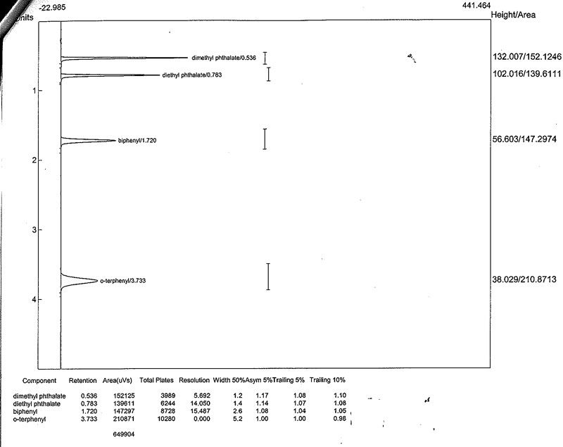

I am working to assemble a QC chromatograph to quantify the effects of various hardware (filters, guards, etc) on separation efficiency, tailing, retention time and such.
The Problem: The RT is very stable and peak shape is consistent from run to run, but I’m experiencing trouble achieving repeatability in peak height, peak area and plate counts from run to run. I can run a dozen sample injections literally back-to-back and get upwards of 30% variability in these values. The variation between runs usually follows a rough (but variable) ratio for each peak and parameter. I notice however the ratio changes from peak to peak and from run to run. I can discern no clear trend in the data.
It seems like a sample concentration or sample injection quantity issue. The sample itself isn’t degraded or evaporating between runs.
I’ve rebuilt the injection valve and carefully controlled my injection technique (full loop technique, 3x-5x loading). I’ve replaced seals and checkvalves in the pump to minimize the possibility of uneven flow. I tried changing UV detectors and replacing the lamp. I have tried several sample loops from 1.5ul to 15ul and a range of sensitivity settings on the detector. Also I purged the system exhaustively and have achieved a very smooth baseline.

I'll attempt to post a few example chromatograms ASAP. Also I'll try this http://www.lcresources.com/resources/TSWiz/hs380.htm
Sorry for the large size, it was necessary for the text to be legible

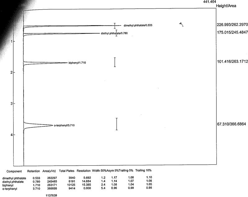

notice how the first two are nearly identical, in fact the plate counts are exactly the same for some of the peaks. Then the values on the last chromatogram are way off.

Based on the three chromatograms you showed, the relative standard deviations of the peak areas are around 35%. The relative standard deviations of the area ratios is around 1-2% (still not great, but a whale of a lot better). That says that you definitely have an injection volume problem (which you already knew!).
The 7125 is a "classic" design; it does not involve any type of "make before break" or pressure bypass. All of the suggestions made so far have been good ones. The only other thing I can think of is a bad needle seal in the valve itself allowing aspiration of some air. Rebuilding the valve should have taken care of this, but I've been known to put one together without snugging the seal down tightly enough.
