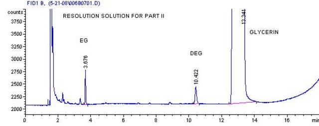

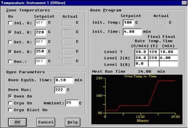

Sounds to me like you're trying to do the Diethylene Glycol and Ethylene Glycol Impurities test in the USP 31 May 15, 2008 Glycerin Monograph revision. OK, your GC conditions don't exactly match those listed in the USP 31 May 15, 2008 Glycerin Monograph revision, but they're not far off. We use a practically-identical 624 column from a different vendor, and we don't have any sensitivity issues. Our vendor lists 240C as the maximum temperature, and you're going to 260C, so maybe you've damaged your column by going to 260C, contact your supplier. Attached are the GC conditions we use (also on 6890A GC), the 60C/minute rate detailed by the USP is ridiculous. Image
Anyway, we use here as our standards the 0.025 mg/ml concentrations for EG and DEG in methanol as detailed in the USP update, see the attached chromatograms.
