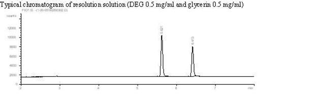

I have to ask why you were instructed NOT to derivatize for this assay? Is your supervisor knowledgeable or have pointy hair? Anyway, if you would like to assay without derivatization, I would suggest columns as those detailed in the USP assay for DEG and related amterials in glycerin, such as a 30 m x 0.53 mm i.d. x 3.0 mm SPB-624 (Supelco #25430) or Restek Rtx-624 (Restek #10971) capillary column. We use this routinely.

Yes, the chromatogram I posted is for underivatized DEG and glycerin. The set up is like in USP for glycerin monograph. This would work for DEG in glycerin -OR- DEG and glycerin.
When I do derivatize DEG and glycerin, I usually dissolve sample and standards in DMF and simply mix with BSTFA (containing 1% TMCS) to derivatize, instantaneous.

It works nicely on a 624 - I should really have tried that before - since its quite nasty on a wax type!
