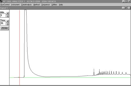

we created our standard and stock solutions last week, and shot a few to attempt to establish our calibration. Of our 4 standards (glycerol, mono-, di-, and tri-olein), only monoolein came out with a decent correlation coefficient. glycerol was particularly hard to detect as it was obscured by the tail of the heptane peak.
We decided to re-run the injections the next day, but we ran into an 'EPPB system shutdown'. It took us a few days to figure out that this was likely due to the injector septa, which we replaced. in the meantime, there was a sample that got left in there with no He purge (EPC shut itself down), and i'm afraid it damaged our column.
I made some new standard solutions this week, but everytime i inject a sample, we only get a few short broad peaks and the tailing of the heptane peak has gotten worse. I'm not seeing any of the internal standards or correlation standards. To try to figure out whats going on, I did a blank run:

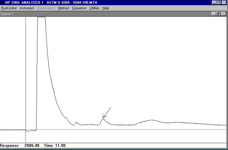

here is a run with internal standards:
note that the attenuation was set to zero on this, i put a marker in to indicate the time and peak height at that point.
I'm not sure if this is due to poor column resolution due to contamination or maybe our mstfa got deactivated. (I purged the mstfa bottle with helium the best i could and kept it in the refrigerator all week. While not a perfect purge, i would expect it to keep longer than a week under those conditions, and at least show some activity.)

What a pleasure to have a question with all the technical detail, and some chromatograms included :) .
A quick and straightforward fix might be to change the guard column: with luck any crud should be sitting there rather than on the analytical column - that's why they are called guard columns.
