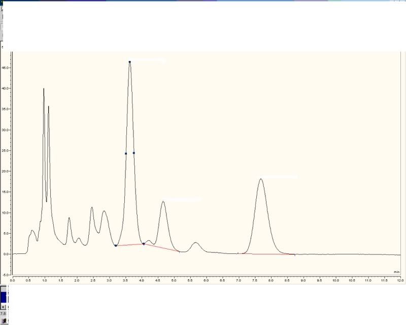

some good ideas there. I've uploaded some traces for inspection. Mine is Image
whilst theirs is Image
peaks 14, 15 and 23 are the important ones.
Hope this works.
Foefot to say, sometimes they dont use the small peak before peak 15, sometimes they do, but the overall result does not change much as its is so small.

The times are way off. Someone is not running at the correct flow rate. If the pressures are also way off, when running at the same flow rates (as confirmed by testing w/ volumetric glassware & stopwatches), someone's column is in dire need of replacement, or someone is not preparing their MP correctly.
If all of these things turn out to be the same, I would look at the calculations. Make sure that everyone is using the same purity & moisture corrections for the standards.

Apart from the retention times being different I am confused by your remark about using three peaks - are you measuring the three different components or obtaining one value by adding the three together in some way.
Thanks again
yes, the retention times happen to be diff in that example. I've been playing about with eluant strength to try and seperate the small peak, the second trace is more realistic day to day retention timewise. Even with same retention times results differ. The calculation combines all three peaks in the ratio 0.5, 0.1 and 0.4, giving a total active ingredient contained in the sample.
MP is an acetonitrile in 1% acteic acid mix, retention times vary with each MP made up only slightly, unless like above I'm trying different things.
Out of interest or ignorance, surely if the retention times were different, the areas under the peaks would still be comparable with others?
