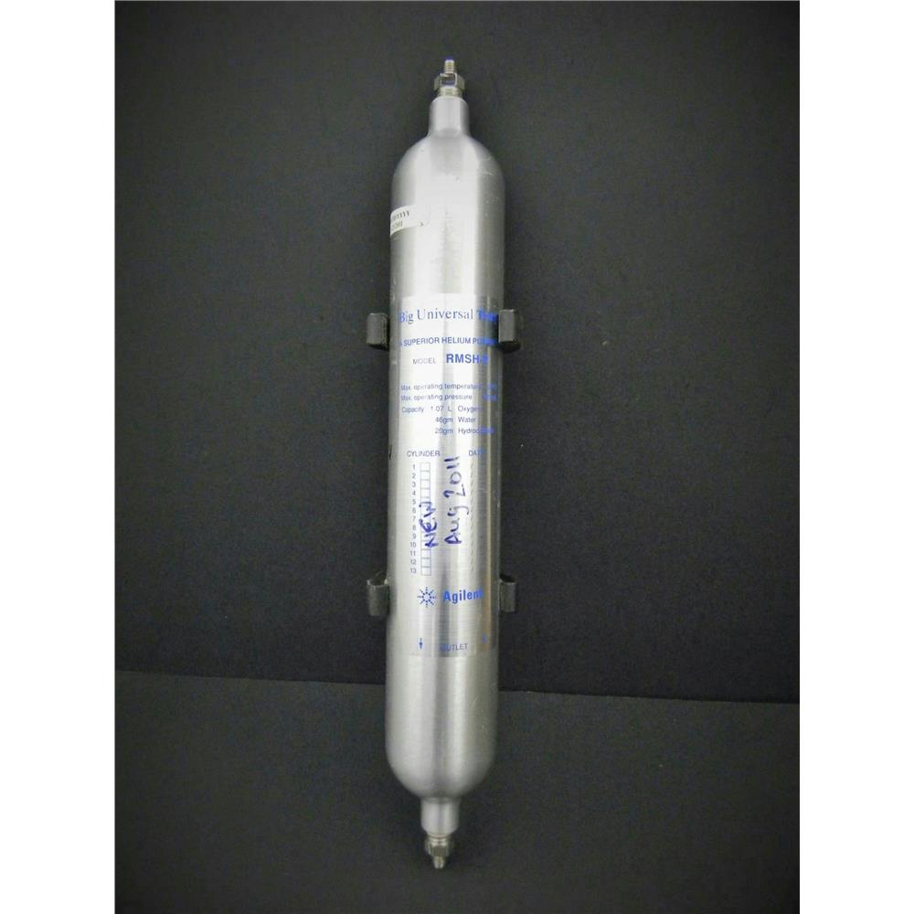

Orientation of the label on trap body suggests inlet joint on the top of Agilent BUT.
http://files1.kyozou.com/Picture.aspx?w ... d=28693165
Otherwise making notes on the label would be inconvenient. Esthetic reasons neglected :-)

I do remember one trap that had a flow arrow and a top label but all of the rest of the label was printed upside down if you installed it as it indicated.
