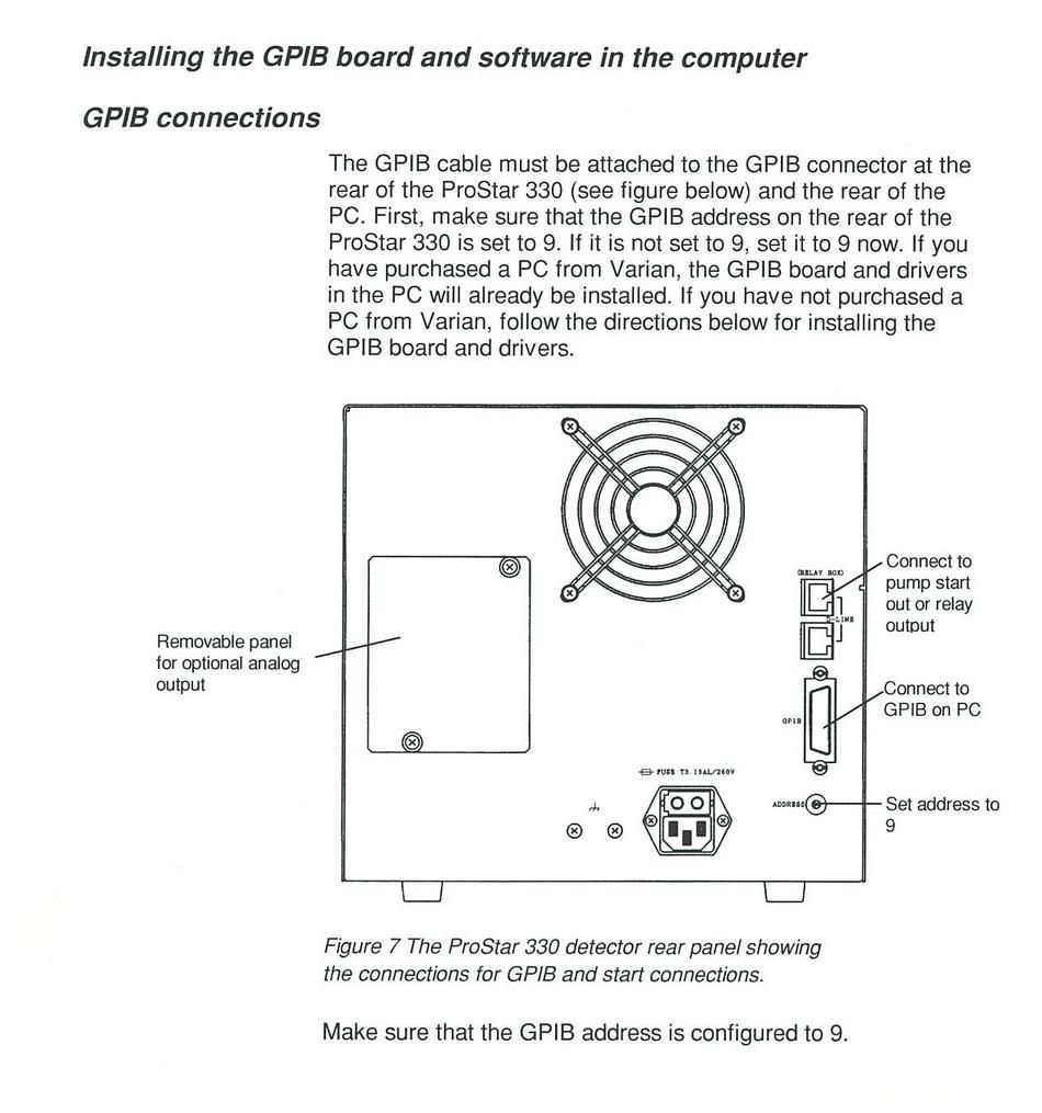

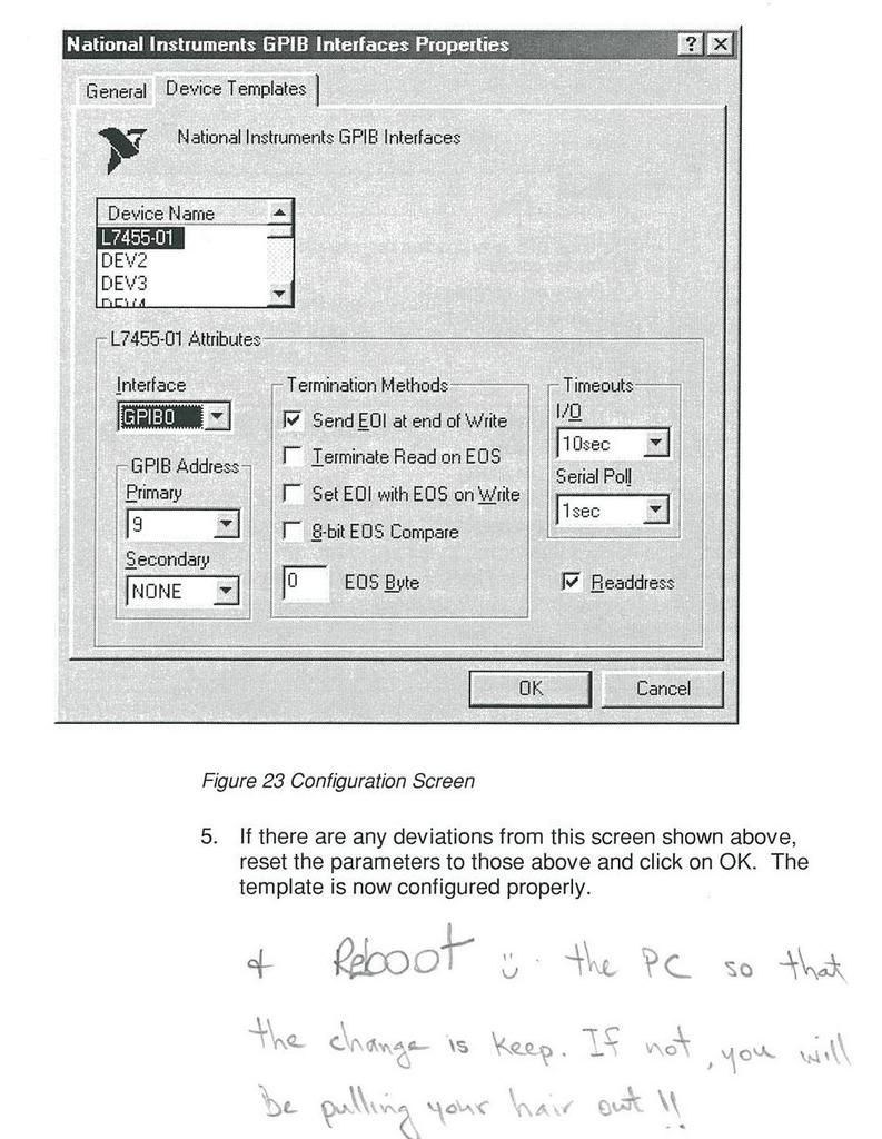

Hi, I'm about to flee work so this is a very quick response. Have scanned you a couple of pages from the manual. p. 49, which I haven't copied, just tells you how to access the Device Manager via System Properties in Windows (sounds like you're way above needing that).
Hope this helps, if not I can scan more.
Thanks for the manual scan! I'll check my settings and see if that's where the problem is. If you get a chance, could you take a look at the manual to see if it specifies a specific GPIB board, beyond "National Instruments"? I do have an NI board, but not sure if it's the right one!
So with my NI board installed with either driver version 2.2 or 1.70, I can open up the board settings, but I don't have the selector for which instrument at the top. Wrong board/wrong driver? ARRGH!

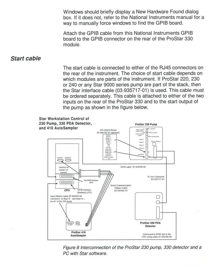

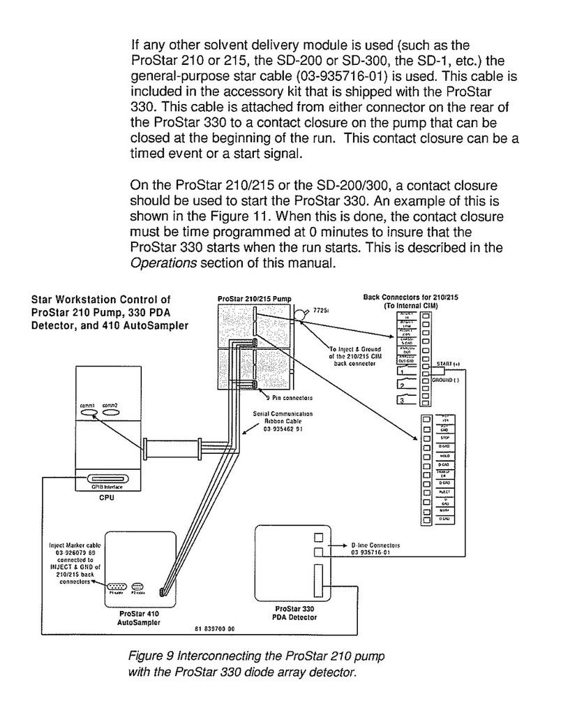

I've scanned some more pages from the manual (below) and also had a look through my collection boxes and CDs etc. The GPIB box has a large Varian sticker on the front emphasising that the instrument stoftware should be installed *before* the card is installed in the computer.
If none of this helps then I'll open the computer case and see which NI board we're running.
