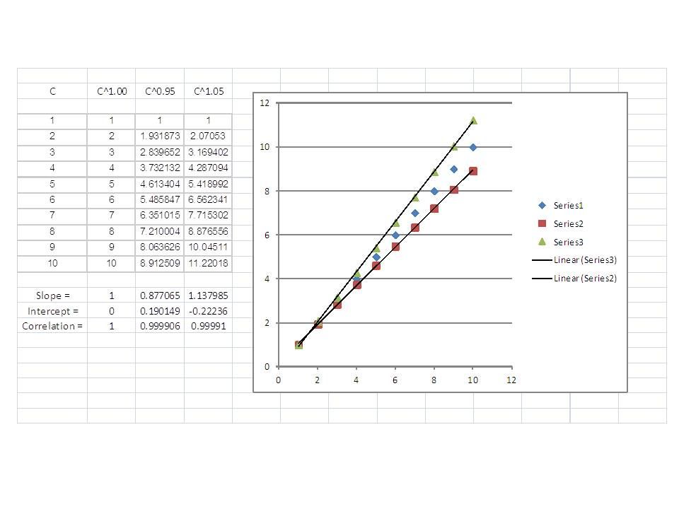

As for that intercept business. In chromatography, at zero concentration, you should have a response that is indistinguishable from the noise of your baseline. If you're really concerned about the low end of the calibrated range, you should be sure to include standards that are way down there. I would include my LOQ standard in the set if I was that concerned. Extrapolating to zero from standards that are far from the origin is not good practice. Including these low-concentration standards will help to guide your intercept toward zero. Mostly, far from the origin, the intercept tells you more about curvature in your calibration data than it does anything else. Ever get a negative intercept? How does that make any physical sense? Generally, it doesn't. Calibration data that is slightly concave upward will give you a negative intercept. If the data is concave downward, you'll get a positive intercept. The y-intercept is actually dictated by the average concentration and average response in your calibration set. That is a point that's relatively far from zero concentration. It doesn't make sense to me to use it. It makes more sense to try to figure out why your calibration data is nonlinear and is giving you a substantial intercept at all.
Here's an example of what I'm talking about. I added a little nonlinearity (5%) to data that should be a perfect straight line, no intercept. Slopes are close to 1 and the correlation coefficients are quite good. Note the sign on the intercepts:

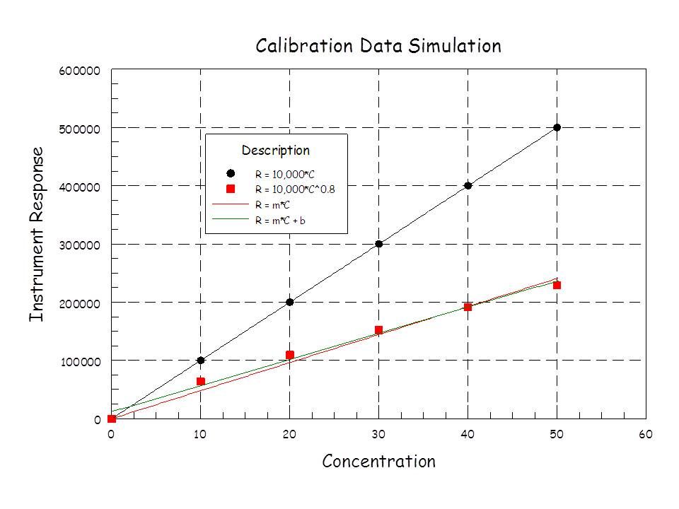

James-- "far from zero" just means what measured response do you have to have that's greater than the intercept so that you get meaningful estimations of the concentration of analyte in the sample. I generated some data by adding 20% nonlinearity. That sounds like a lot. Then, I calculated the regression constants for the various fits:
The R^2 for each of the linear fits to the nonlinear data were greater than 0.99. You can see that y-intercept is starting to get big for 20% nonlinearity. What if you have an instrument response of 12,000 cts for your analyte that can be measured reliably? In this case, for the 2-parameter data you'd have to say that the concentration in your sample is undetectable. Whereas if you use the 1-parameter fit, the concentration is estimated to be more like 2.5. To get results that are not substantially skewed by subtracting the intercept, you need to be at 120,000 cts or so.
If you are interested in determining concentrations at the low end of your calibrated range, at the very least, you need to include standards that are down in that range. You can't calibrate far from zero concentration and then extrapolate down there. You have to drive that intercept down as low as you can get it. If you merely choose standards arbitrarily and then try to make predictions using only the regression constants, you can be in a danger zone at the low end.
