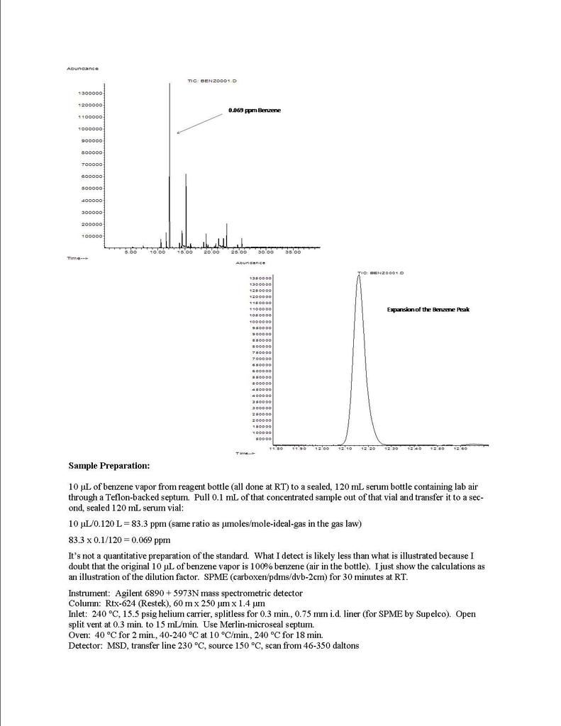

I did this really quick. Gives you an idea of the peak shape I'm getting on the Rtx-624.
http://i1285.photobucket.com/albums/a59 ... gsrrgi.jpg
