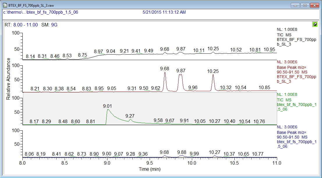

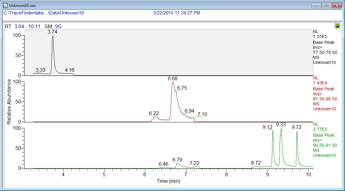

The STD and ISTD solutions were prepared 6 months ago with a concentration of 10 mg/l. They are prepared in acetone to be able to spike water but also prepare injection standards in pentane. I experimented with 700 ug/l (700 ppb). Two weeks ago the Full Scan spectrum looked like the top row, and the 91 ion looked like the second row. Now it looks like 3rd and the 91 ion XIC like the bottom one.

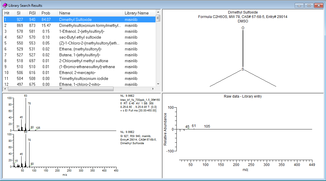

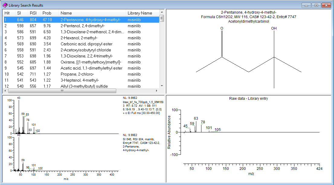

The ratio is fixed so first thing is to notice is how little the bottom peaks are for Ethylbenzene and Xylens. Second thing to notice is the huge horrible peak at 9.01. Remember, this is the SAME standard solution I injected 2 weeks ago. Since is full scan I did a database search and identified the 9.01 to be:
The small peak at 9.27 seems to be:
Well, the original CRM ampule had the compounds in DMSO. The 2-Pentanone, 4-hydrohy-4-methyl I really don't know how it got there. Maybe is secondary reaction of the pentane with acetone or so...

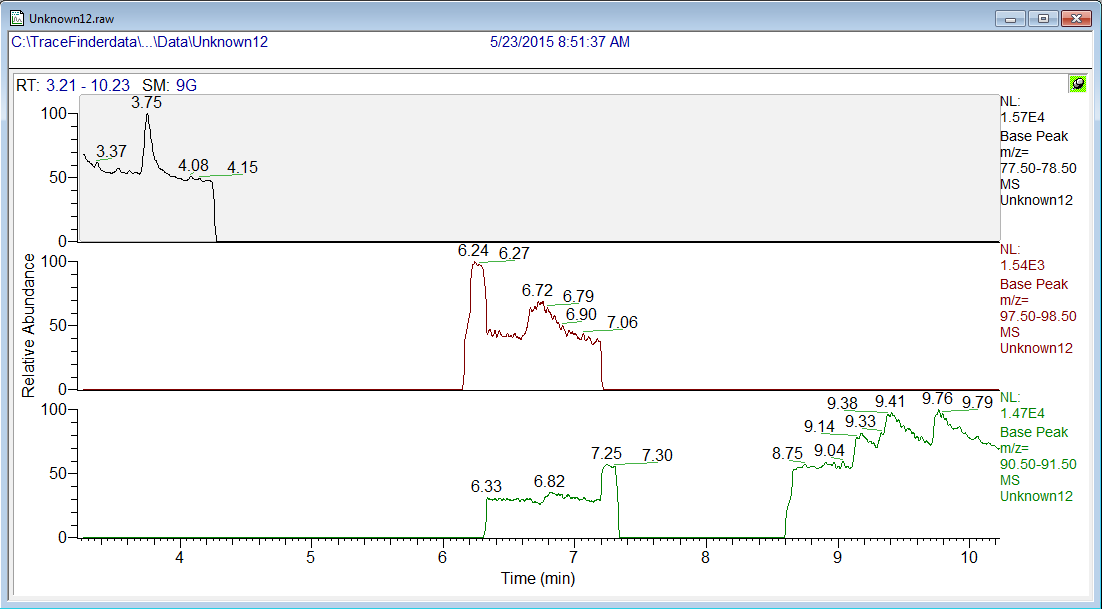

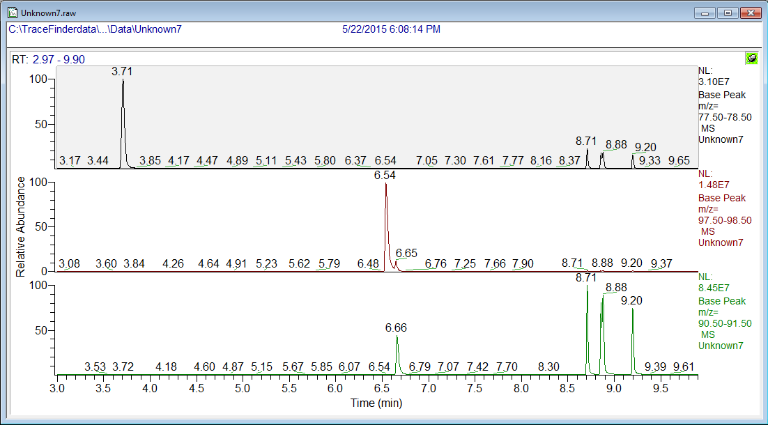

This is how it originally looked 2 weeks ago in SIM, the order is: Benzene, Toluene-D8, Toluene, Ethylbenzene, m,p-Xylene, o-Xylene.
Now it looks like this:
Sensitivity is down one order of magnitude, and the toluene peaks are horrible, with a huge tail.

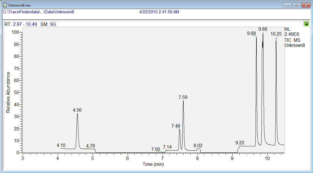

To be sure the column is still OK, I prepared a 700 ppb BTEX in methanol (new CRM) and did a manual headspace analysis, 10 ml water, 30 min equilibrium time, 1ml injection, same GC conditions like for liquid injection. Resulted this full scan:
So the column is OK.
For fun I injected the 700 ppb in menthanol. Resulted this in SIM:
Conclusion: never use methanol as a GC solvent :)

Kind of a coincidence - just today I started seeing 4-hydrohy-4-methyl 2-Pentanone show up in some of my runs. I ran out of DCM so I was using 1:1 Hexane:Acetone in its place to do soil extractions. This compound is diacetone alcohol, and one source I found online said it's a common contaminent in acetone. I don't know what factors accelerate the formation (temp? active sites? contamination?) but maybe that's all it is.
