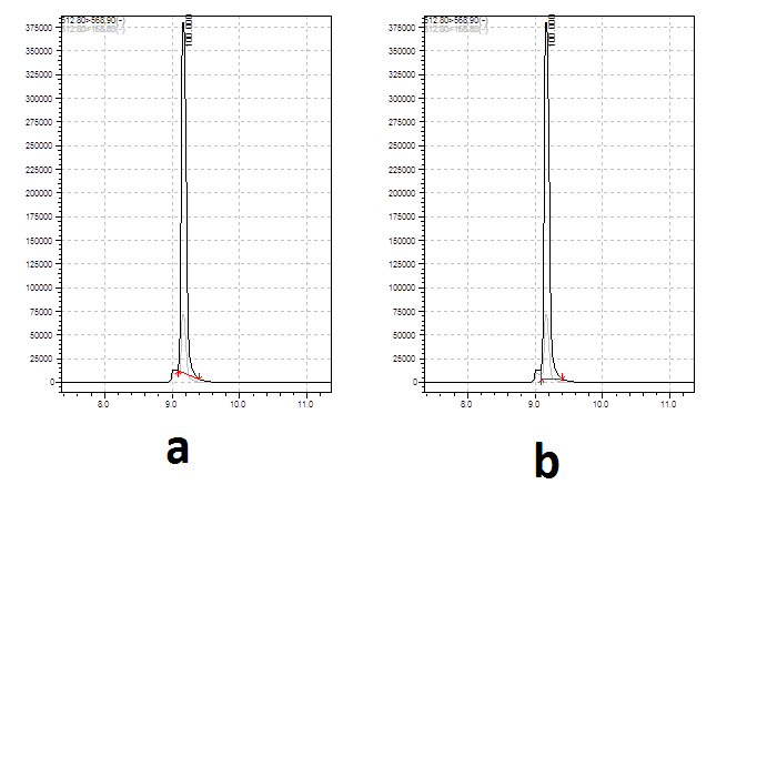

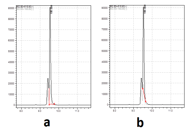

Thank you for your reply, Peter. But in several cases the difference between two areas may reach 20%. Please refer to the pic posted below.Take your pick - by eye the relative difference between the two areas will be less than 2%. If that makes a practical difference then you need to get the peaks separated or find a selective wavelength.
As long as you do it the same way every time AND as long as the small peak in front of your analyte always stays about the same size your results will still be repeatable.
I wonder that which peak area selection method is more acceptable without separating the small peak in front of my analyte.

If the interference peak varies by that much then you have to go with A, but you really need to improve the chomatography - you have lots of space either side of these two peaks to shift them into.

In my opinion, B in the first example and A in the second.

This is how the intergation of the peak should look like. I think only couple of chromatographic programs can do this.
If you have trouble with not separeted peaks you can always make a baseline and use peak height instead of peak area.

I disagree I'm afraid. The reconstructed peak shape assumes that both peaks have an ideal shape, and is still vulnerable to changes in the size of the interfering peak. And if the target peak is riding on the tail of an interference than there is no way of knowing where the baseleine should be set.
