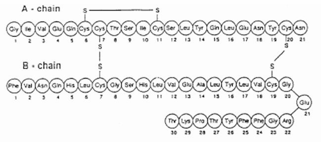

As for the insulin, the insulin was not prepared fresh (it was prepared about a week earlier at 1 mg/mL, stored at -70°C in 30% acetonitrile/0.1% TFA), but the degradation products I would predict are substantially different from that ghost peak. The ghost peak would have to be a dipeptide or an amino acid, due to the time of elution, while the predicted degradation products of insulin would be the A and B chains:
The protocol we utilize is modified slightly from Leitner et al., 2013 [1], where the A chain is actually a standard in the mixture:
Protein 1 is insulin, 2 is insulin chain A, and 3 is angiotensin II.
[1] 10.1038/nprot.2013.168
