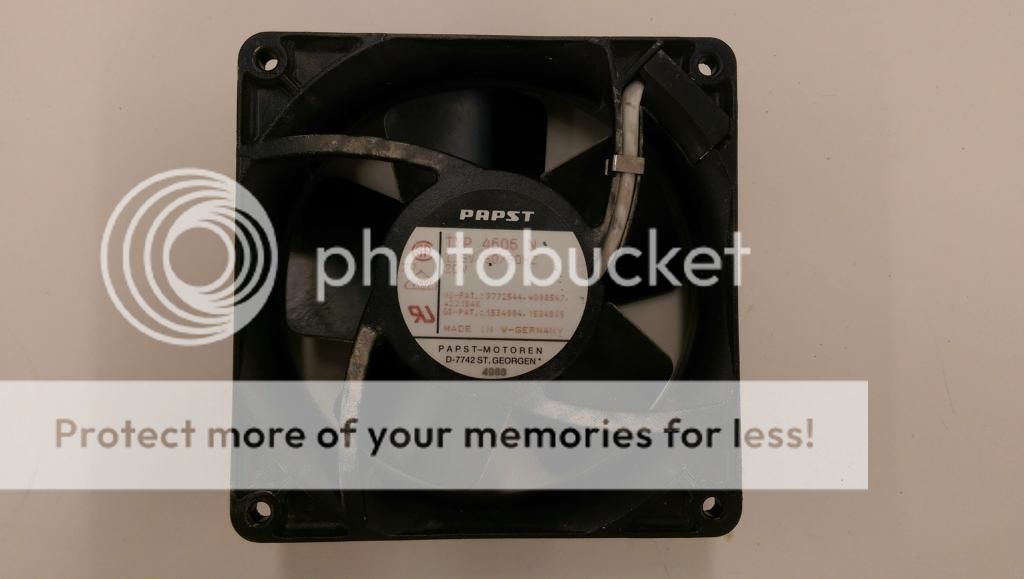

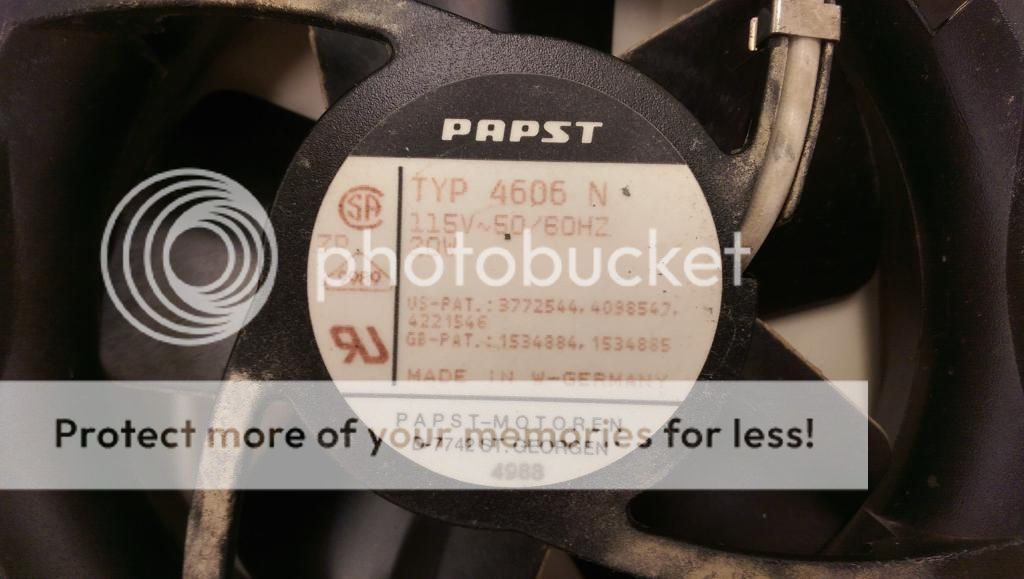

Hello Here are 2 pictures of the fan.
Dimensions are 120mmx120mm
I guess I was worried it would be hard to find them. But I see them several places on the net.
I contacted Sisweb and they have these in stock.
Under the sticker there in the photo is where you can lubricate those fans. They are made to just be changed out when they go bad, but for the length of time we normally use such pieces of equipment, lubricating them easily should have been a option.
