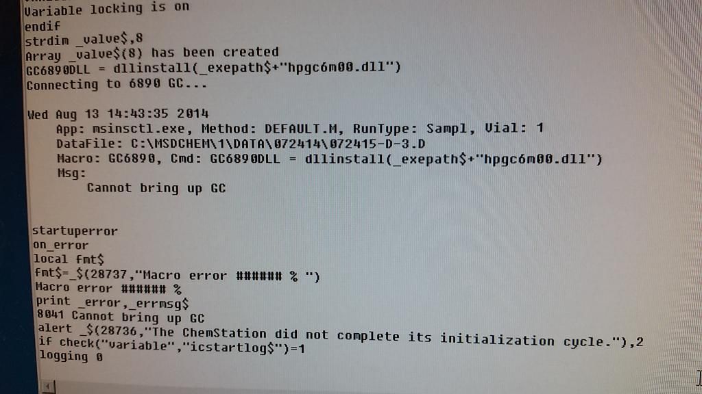

Then the application closes and I am prompted with this error log
I wasn't sure if the whole log was necessary but this was at the bottom of the page
http://i40.photobucket.com/albums/e247/ ... b39655.jpg

Hello Mr. Kubowicz,
I did exactly what you told me to do, removed all the instruments and created them again, but the software still did not initialize all the way. It prompted the same error messages with the same error log

If it is something with .dll files I'd suspect that MSD Chemstation library files were overwritten by something else (perhaps other installed programme).
You can try restoring your computer's system to an earlier date when everything worked correctly. It is simple Winows restore procedure.
