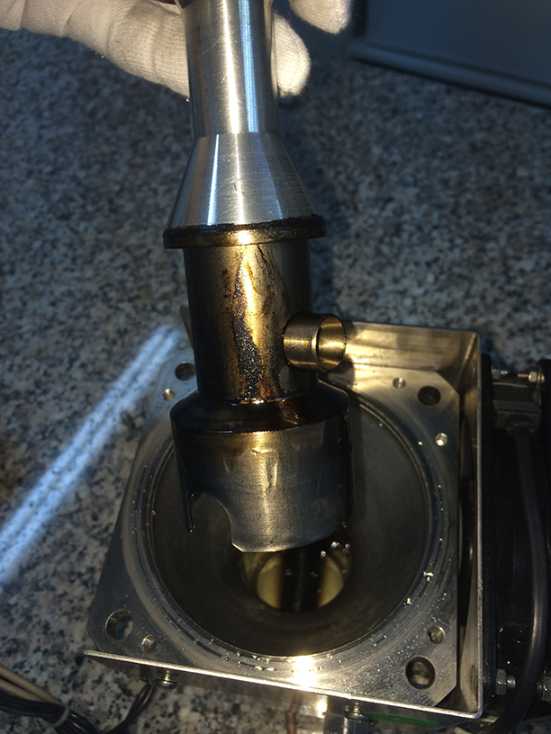

My diffusion pump started to fail, so I opened it and I was amazed what I found. The left fan had voltage reversed so all the time both fans were pulling air in from both directions, instead of tunneling it. Because of that, the left fan was venting hot air from the GC, directly on the pump's baffle. After I corrected it, no more temperature fail on the diffusion pump. The problem is, I think it damaged the Peltier element, I will test it next week. Also let me show you a picture from inside the pump. They put normal external pump oil inside, instead of the VERY expensive and special Santovac 5 oil.
