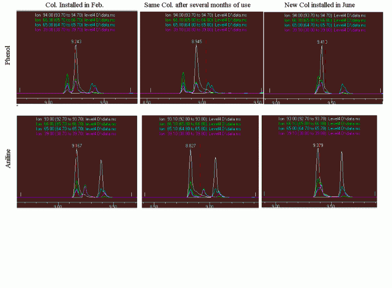

Sort of bumping up and old topic but I still have the same issue. I tried running an empty injection as suggested but didn't see anything that stuck out too much. Peter suggested that this might be just normal with a new column. I did compare to my old column shortly before I replaced it, and also to that same column when it had first been put in in February. When it was new it still got better seperation than the one I'm using now.
Here are a couple images to show what I mean:
http://i8.photobucket.com/albums/a41/ra ... niline.gif
http://s8.photobucket.com/user/ralphsin ... l.gif.html
Does this seem like something to be concerned with and/or is it anything that I can do something about?
