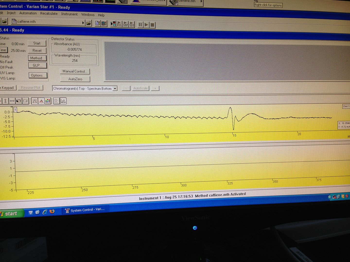

The mixing noise from this tee was nearly 1mAu! In another instance I've used a tee to connect the solvent lines, and a 75ul Perkin Elmer series 200 dynamic mixer. The mixing noise is about 250uAu end-to-end, way higher than I would like it, but better than the mixing tee.
Here at 15min, you can see the moment where I turn on the dynamic mixer and mixing noise decreases.
