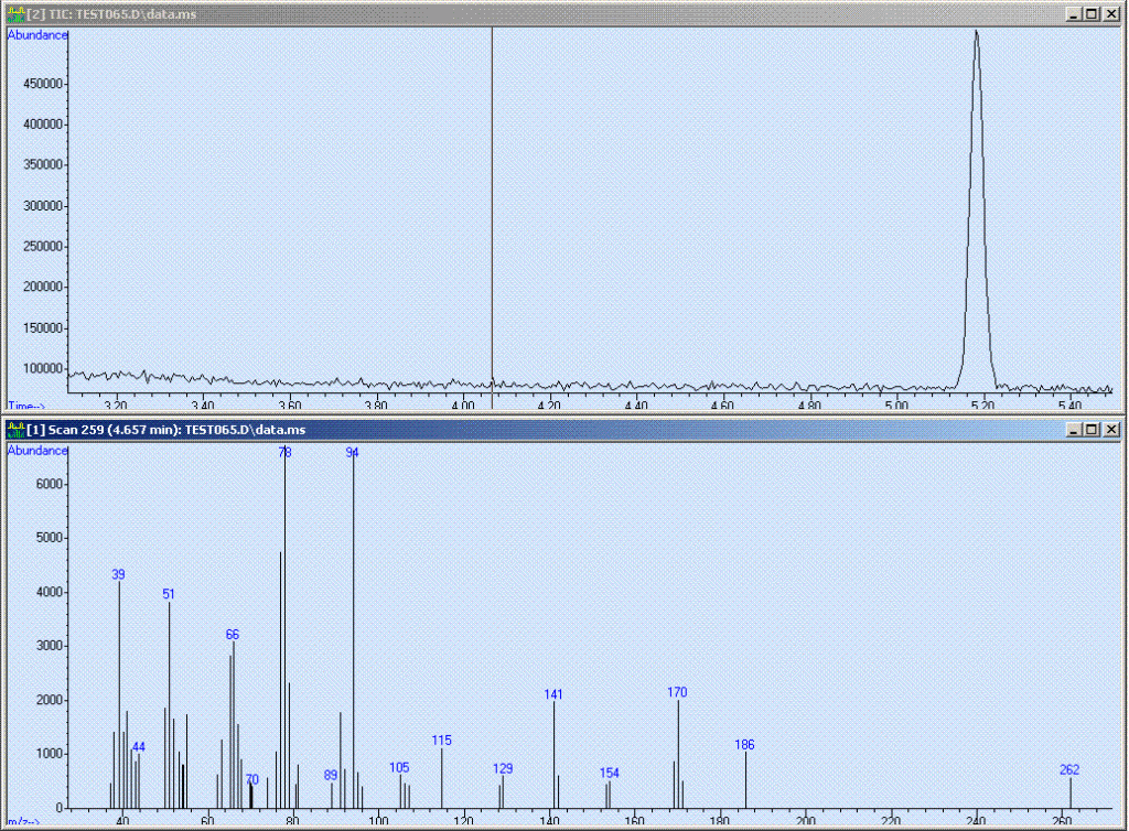

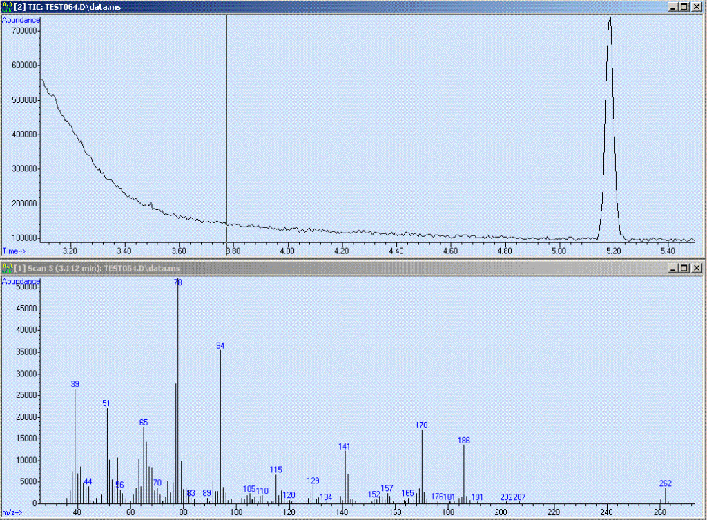

Two injections of BFB gave these results
I can't quite figure out what that background spectra is, and it seems to build up on the filaments over night as it is the same spectra in the raised portion at the beginning of the first chromatogram that goes away with the second injection. I have added a moisture and oxygen trap to the gas line, may try adding a hydrocarbon trap also just in case it is something coming from the hydrogen tank. All stainless steel lines and regulator being used and I have eliminated the purge and trap from the system too to try to find the source of the background. Our hydrogen generator isn't putting out enough pressure currently to add this instrument to it, so using ultra pure hydrogen cylinders currently.
To get the 95/96 mass ratios low enough to pass I have had to drop the flow down to 0.3ml/min which is still about 31cm/sec so not too bad.

I am noticing that the initial hump of background reappears when you let the instrument set for only a few hours. Whatever it is it accumulates fairly quickly in the system. This happens while the column temp is held at 150C, which is the starting temp for the runs so I believe it is accumulating on the source not so much in the column. I have the interface set well below the max temp of the column also to prevent excessive bleed and damage to the stationary phase. These are instruments that normally run volatiles by purge and trap, but I have taken the purge and trap out of the system to make sure the background is not coming from that.

There are a couple losses there in the spectra that come out to be 16 which would point to loss of Oxygen, some are 12 which would be a single Carbon not a CH2 or CH3, which seems a little odd.
78 mass would normally correspond to a benzene ring, then the next mass up is 94 which is +16 which would give a benzene ring with an oxygen attached. It would appear to be some type of substituted aromatic compound but I am not sure if that could come from anything within the system or not. I wish I had NMR and IR to go with it, maybe I could determine just what it is :) Haven't done and complete unknown like this since college.
