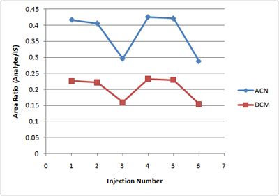

I am experiencing weirdness. One analyte of three in the same solution has large changes in area count, while the other two analytes do not.
GC: Varian 3900 running a DB-624 30m x .53mm x 3um column, 1ul injection
Temperature ramp from 40C to 200C over 35 minutes.
Injector port at 220C, detector 225C.
Split ratio 10:1. He / H2 / Air system
Solutions: ACN 79ug/mL, DCM 132 ug/mL, Ethyl nicotinate 111 ug/mL in DMSO. Ethyl nicotinate is functioning as the internal standard.
Area counts (individual vials, same prep)
Inj ACN DCM EtNic
1: 379 206 909
2: 375 205 924
3: 359 194 1213
4: 392 214 921
5: 395 215 938
6: 360 193 1249
(sorry about the collapse of the formatting there)
Is this non-homogeneity of the solution? An intermittent active site in the instrument? Funky autosampler activity?
Thanks for any insights ya'll may have.
Ned

Was the the order they were injected? If yes, you have 2 good ones and a bad one, then 2 good ones and a bad one. Sometimes these types of patterns can tell you something about what's going on. Why might it be "2-good then a bad"?
Most likely cause is the inlet discrimination, a combination of the back pressure from the splitter outlet and the placement of the column tip in the injector, and the direction the needle point (assuming you have a tapered needle tip).
The good news is the areas trace each other.
Since DCM is not that reactive it seems to be a physical problem, not a chemical one.
I still note that the IStd does NOT follow the same track. That is a chemical problem.
When one has two concurrent issues it certainly can be a pain.
best wishes,

And again, what happens with several injections from the same vial? Looking at what you showed for data, I tend to suspect the samples as a source of problem, particularly with four samples looking so much alike and the other two being out of line.
