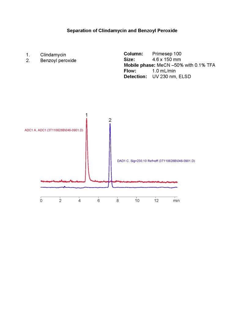

Here is application for separation of clindamycin and benzoyl peroxide. You will need to use two detection techniques as clindamycin has very limited UV:
Clindamycin is retained by combination of weak RP and strong cation-exchange, BP is retained by pure RP mechanism. You can change order of elution for compounds by changing mobile phase composition.
contact me if you have questions.
Can i have the method of analysis?THANKS
All method details are on the slide. You need Primesep 100 mixed-mode column, once you get it I will guide you through method development.
