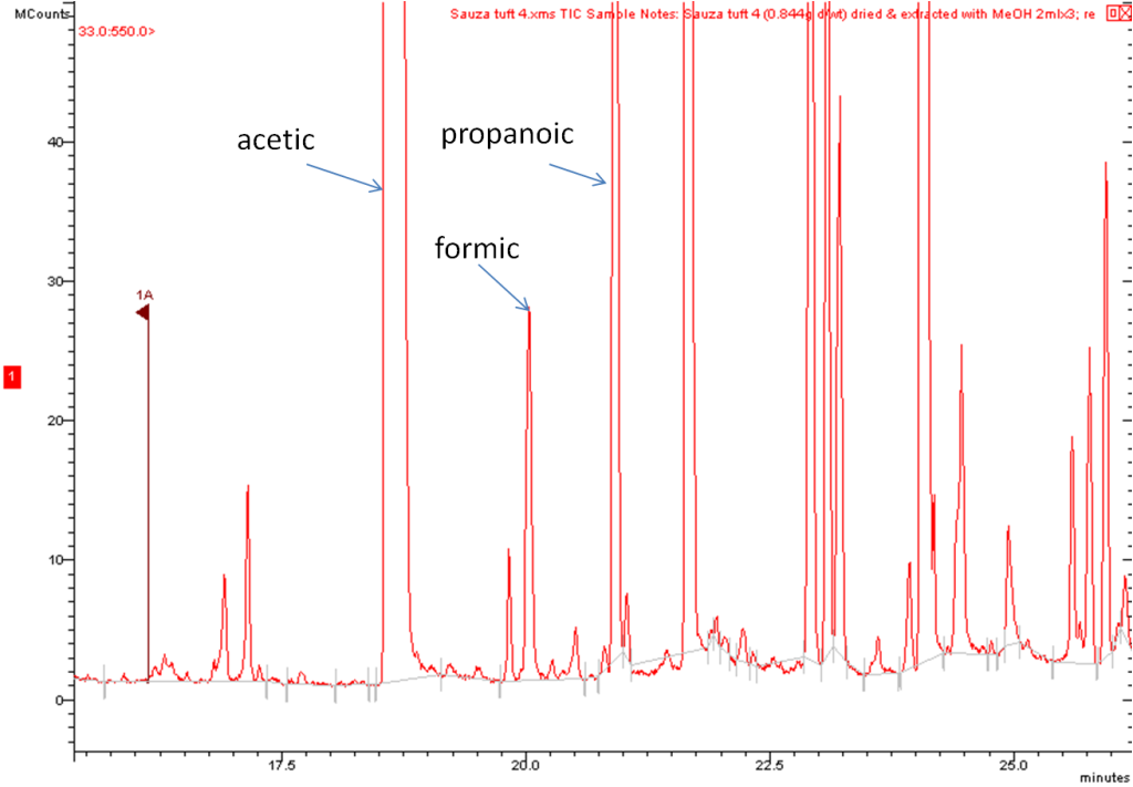

I see formic acid as a nice sharp peak midway between acetic and propanoic acids on Restek PEG columns (RtxWax). The samples are wild dog urine and faeces, and so they have a multitude of bacterial fermentation products in them.
Peter, would you be willing to share a chromatogram of this analysis?
thanks
jaap
No problem (as long as the link works !!)
Thanks Peter. This looks very good. What detector was used? It looks like MS. was this a 1 micron film on 0.32mm?
Hi Jaap
This was a 0.5 micron film, 320 micron internal diameter, starting temp 40 C, programmed at 5 C/min. MS detection - formic acid is nearly invisible by FID.

Yes, methanol solvent. We use it because it gives us the broadest range of extracted compounds form the wild dog materials. We are seeing diols and glycols that would never extract into the more usual non-polar solvents. I doubt that we would see formic acid with a non-polar solvent.
The anticipated problem with formation of methyl esters of free acids has not arisen - we always analyse within a maxium of a few hours of preparation and store at -18C. Also we do not dry the extracts (the samples themselves, except for anal gland secretion are air-dry before extraction), and I suspect that the traces of moisture inhibit esterification.
The only disadvantage is that methanol extracts urea and then gives methyl carbamate as an artifact peak.
In case anyone would doubt Peter's results (a deed, foolish as it is unlikely), formic acid does elute where Peter says it does.
