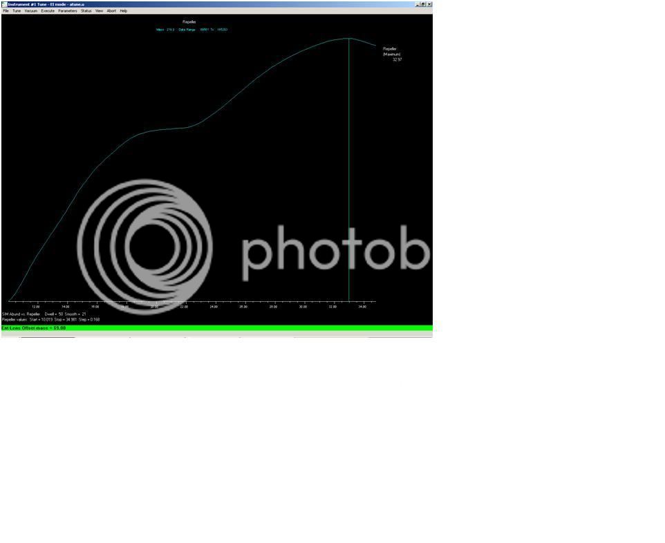

Usuallly the ramp on the repeller will look bad if the repeller is bad. Is the autotune setting the repeller value to a similar setting as in previous good tunes? Is your EM voltage similar to previous good tunes or has it increased a lot? How old is your column? Have you clipped both ends of the column? May want to take about the length of the transfer line off the back end of the column to see if that is the problem. It's true, you're flow shouldn't go to 0 when doing a splitless injection.

Does this repeller ramp look ok I don't remember it having a shoulder like that.
