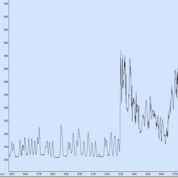

Here's the latest of my many issues, I'm running a 1 ppb standard of all 209 pcb congeners. ms is in sim mode. the following chromatogram shows great peak shape up until 63 minutes, when all hell breaks loose. This does not happen every run, some runs are flawless, others are useless as this one is. Total run time is 109minutes so this event took place 40 minutes before the end of the run. I believe something is very very wrong with the mass spec. we've taken it apart and cleaned it. this happens....any thoughts as to what may cause this? Also..sometimes it "recovers" and peak shape suddenly returns.
Christian

EM volts are at 1118 with no added voltage. Air and water checks are well below 10%, I don't have the exact numbers in front of me. I'll have to compare the tune to an older one, but nothing stands out. Also, this mass spec is only 6 months old, and no "samples" have been run. I'm still in method development stage right now. I was collecting full scan and sim data, sometimes it would affect just scan, other times both scan and sim. We are not collecting scan data right now (with the run I showed...). yes to using alumina. yes this was happening before we cleaned..
Christian

I have since pulled the pcb column (rtx-pcb 60m) for a rtx-5sil ms 30m ..trying also to develop a PAH method. I still get incredible noise on simple solvent blanks, when I click anywhere on the chromatogram, EVERY ion is accounted for. There's something very wrong with the mass spec. I think it's time I called agilent. I will run "blank" runs today to take the injection out of the equation.
Christian
Our GC guru has agreed there was a problem with the EM. An autotune run with transfer line capped showed 672 peaks. EM has been replaced. I will try running standards tomorrow. To tlahren, do you believe the 6mm drawout plate will give me better sensitity? I am buying one to try. I cannot tolerate injecting 10uL anymore. Samples leave an unknown deposit on the inside of the liner and my closing standard goes crazy, with response of low chlorinated congeners increasing by 50% and heavily chlorinated congeners decreasing by 50%. I am doing a sulfuric acid cleanup on all samples and I'm wondering if a small amount of acid is being injected, thus interfering and throwing out the calibration. Right now I can run 10 or 12 injections and the liner is trash. If the new 6mm plate helps with sensitivity that would be a blessing. My goal is to run 2 picograms on-column. Anyone laughing??? Can this be done??? I am running a 5975C with inert source.
