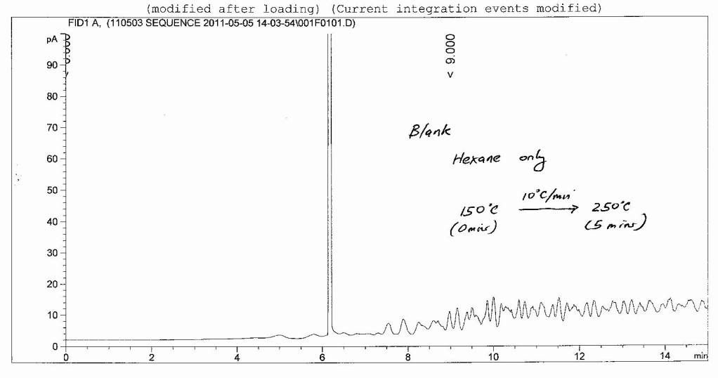

I'm fairly new user to GC-FID and I'm having a bit of problem with my (new) Agilent GC-FID 6850 that I'm hoping someone can help me with. The problem consists of ‘noise’ or a possible contamination, after about 5-6 minutes on a 150C-250C gradient (10C/min) after the solvent peak and about 16 pA. The column is HP-88 (100 meters, 0.250 mm ID, max temp 250C) and inlet temp is 250C, and FID is at 300C. The carrier is helium, and with air and hydrogen for the FID. The issue appears to have started around the time that I injected the Supelco 37 FAME samples (10 mgs/mL, 1 uL injection, ranging 10:1 to 50:1 splits) and biodiesel transesterification reactions of plant oils.

I have then removed the syringe so there was no actual injection, but without improvement, so the issue is not with the syringe apparatus. Our helium line (carrier gas) is filtered, but the air and hydrogen are not (but have ordered filters). I disconnected the column from the FID, and the problem does not occur afterward, so I had think it must be with the column or inlet. Isotemp runs at 150C and 175C do not produce any problems, but runs at 200C and 225C have increasing ‘bumpy’ baselines, so perhaps something with high MW is on the column (or inlet) that is heating up and coming out.

Chromatograms:

It seems you have done quite a to alleviate this issue. At first glance, considering your column temp has a max of 250C I would lower the temperature of the FID to be with in the range of the column. That being said I would take out the jet to see if any silica residue is present, if not still consider dropping in a new one.
Since you have eliminated a lot of possible problems with the troubleshooting so far there are some additional tests to try.
If the GC is in standby, with the column at say 60 C for a long period, and you then do a no injection programmed run, do the noise peaks get bigger ?. If they do they are getting onto the column with the carrier gas. This implies that they are coming from the inlet, or from the gas itself. If they stay the same size they are coming from the column itself, either from phase breakdown or ghost peaks..
If the inlet is cold and the GC in standby with the column at 60C for the same period and you do a no injection blank run, do the peaks get smaller ? If they do they are probably coming from the inlet.
When the GC is in standy is the inlet split or splitless ?, and do you have the gas saver running ?. There might be heavy muck in the split line that can diffuse back into the inlet under splitless flow, or with a low gas saver flow.
Do you have any packing (glass wool or whatever) in the liner, if so try an empty liner.
In my experience baking a column has limited benefit - if you do want to bake it then connect the detector end to the inlet and leave the other end free, that way you drive heavy muck back out of the inlet end (now downstream) rather than further into the column.
Since you only seem to get this junk when you ramp, it makes me think that something is loading on your column when it is cool. Follow the troubleshooting tips provided by the previous post and let us know how it turns out.
Don Shelly
Don Shelly Consulting, LLC
don.shelly@donshellyconsulting.com
Hello all,
Thank you for all your suggestions. I still got the baseline problem when I put on a brand new HP-88 column, but not another different column. Quite confusing for me. An Agilent service engineer came by, and determined that the baseline issue is not contamination, but actually colummn bleed when the temperature is gets too high (apparently above 220C). In this case, this issue is resolved by simply not going above 215C, and which was confirmed by running various FAME standards.
Thanks again.
Thanks for the feedback - can you do what you need to do with the lower limit on the programme temperature ?
