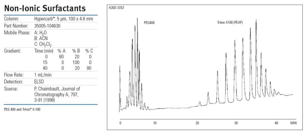

Here is a pretty good method showing the feasability of PEG on a Thermo HyperCarb. Just a Water/ACN gradient, elutes in less than 10 minutes. The HyperCarb column is a porous graphitic carbon, pH range 0-14. More retention than a C18, basically bullet proof, 400 bar pressure limit. You can use a 100mM HCl solution to clean off the column, really helps eliminate sample carry over...
Or look at page 8 of the file below.
