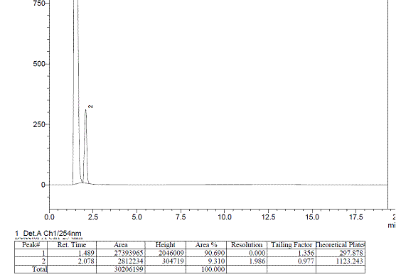

shimadzu chromatogramImage

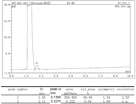

Dionex chromagogram

I've pasted the chromatogram and the graident.The peak 2 in Dionex chromatograph is 0.04%(realated area), well, it's up to about 10% by Algient 1100 and Shimadzu. I can't uederstand......

Ok, next question: what size column and what flow rate?
If you are using a 150 x 4.6 mm column at 1 mL/min flow rate, for example, then your column dead time will be around 1.5 minutes, which means that the neither peak is well retained, in which case a dwell volume difference (as suggested by rwang) could result in "funny" peak shapes and responses.
A good rule of thumb in gradient LC is that the first peak of interest should elute no earlier than 3x the dead time in order to get away from t0 anomalies.
In addition to the comments/suggestions above, I’d suggest you to lengthen the equilibration time, because I don’t think your column is equilibrated in just 5 minutes.
Finally, you’ll need to start with a lower ACN concentration and make the gradient even shallower in order to retain the compounds adequately and thereby achieve a reasonable separation.
yeah, I think the stationary phase can't retain the compounds.But when I reviewed literatures I got this method, I still can't figure out why they chose this methdo. And do you really think that dead volume can cause a peak so "big"(about 10%) ? I'm not sure about that.
