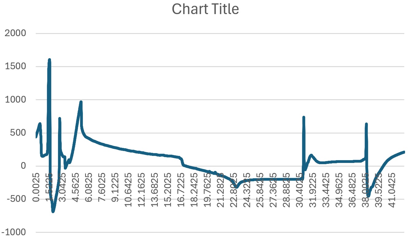

6.Abnormal Chromatogram: The chromatograms for the blanks look strange. Do you know any potential reasons for these abnormal baselines?
Thanks a lot for your reply, it's very helpful!
