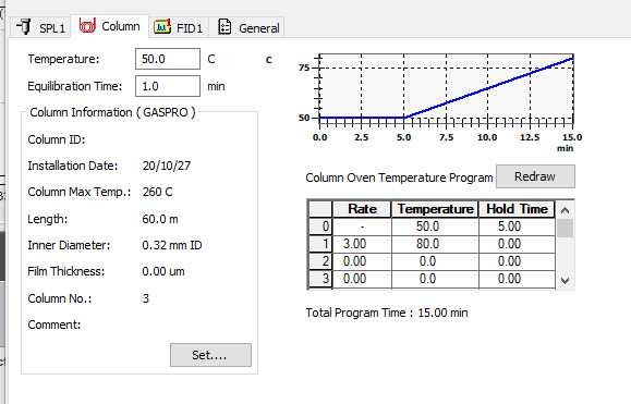

The Method
https://i.postimg.cc/fRTG8xbQ/Weixin-Im ... 184605.jpg
https://i.postimg.cc/nhPPTg5q/Weixin-Im ... 184614.jpg

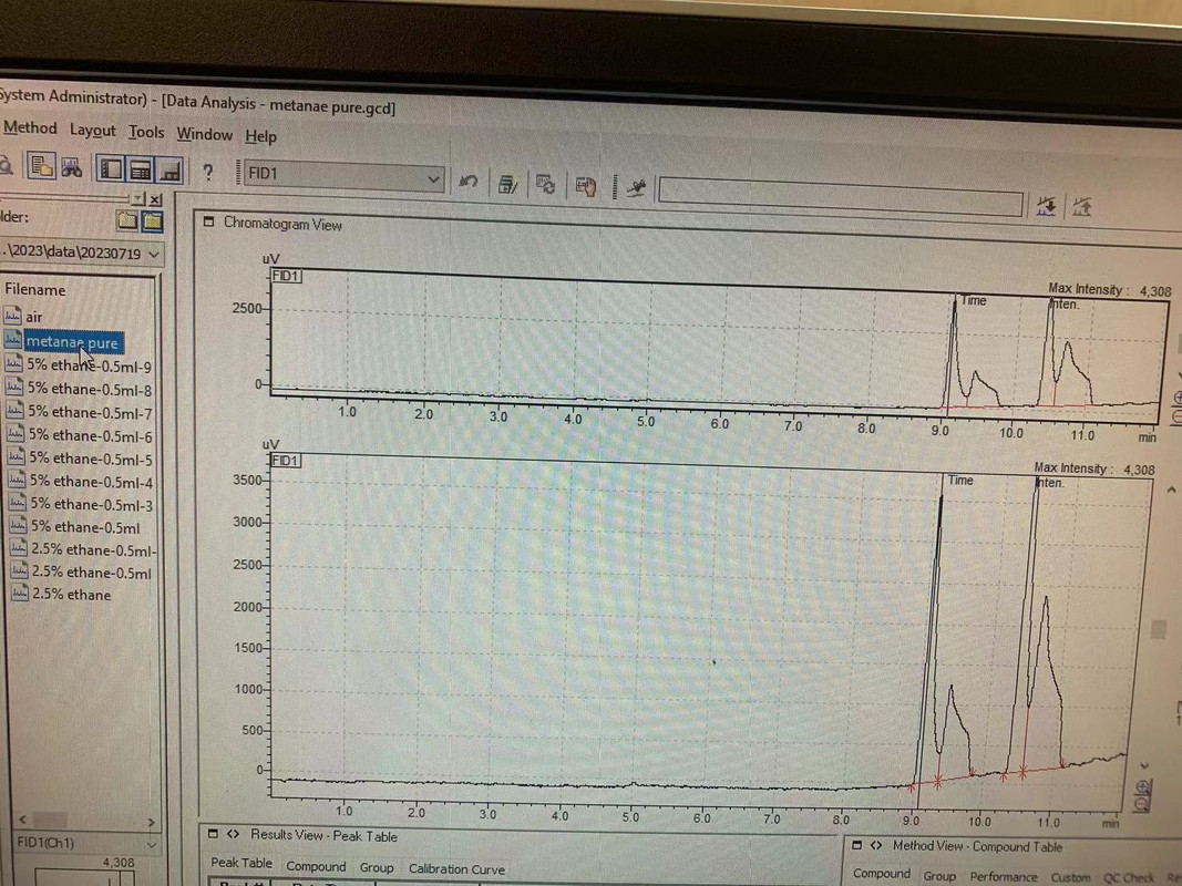

Problem Pictures
https://i.postimg.cc/W1S4JHLg/Picture1.jpg
https://i.postimg.cc/QtRYs7sC/Weixin-Im ... 184221.jpg
https://i.postimg.cc/bYk3ksp0/Weixin-Im ... 184224.jpg
Does anyone know what happened? Why would the peak split in such a way?

It looks to me like you have plenty of signal, if I'm you I would try a split injection. You can adjust the split ratio to get the sensitivity you need. I bet your peak shapes improve dramatically if you split the injection.
claserj,
I'm with rb6banjo. YOu can certainly stand to go to a split injection at a minimum of something like 10:1 based on what I see. The other thing I notice is your column flow is really low. 0.32's run best around 2-4 mL's min and you are supplying less than 1. Try taking that up to around 2 or 3 and see what happens.
Best regards,
Dear rb6banjo and AICMM,
Thank you for your help. We injected the samples in split mode 1:10 and the peaks no longer split. We also adjusted (reduced) the flow rate, and now the peaks have less tailing. Thank you!
