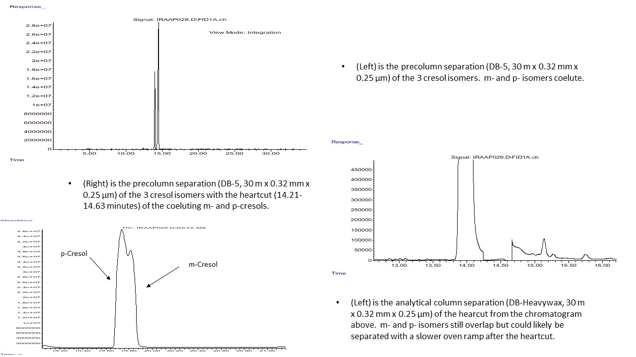

This is how I would do it in my lab. The graphic describes what I did here. I created a mix of the 3 cresol isomers on a tenax sample tube and used my 2D thermal desorption system. It's not GCxGC but it does allow for separations in 2 dimensions with a simple heartcut of the coeluters on one column to a phase of completely different polarity as the second dimension.
The m- and p- isomers overlap significantly on the DB-5 phase (top of the slide). If I run the mix again except cut the overlapping m- and p- isomer peak to the Wax phase, I get a better separation of the m- and p- isomers but they are still overlapping significantly. I can't devote any more time to this but I'd bet that if I slow the oven temperature ramp after I make the heartcut (~14.6 minutes) to something slower than 10 °C/min (perhaps 5 °C/min) I could separate them much better.
This thought process has bailed me out countless times in my 30+ year career.
https://i.postimg.cc/rsnXCsTT/Heartcut- ... resols.jpg
