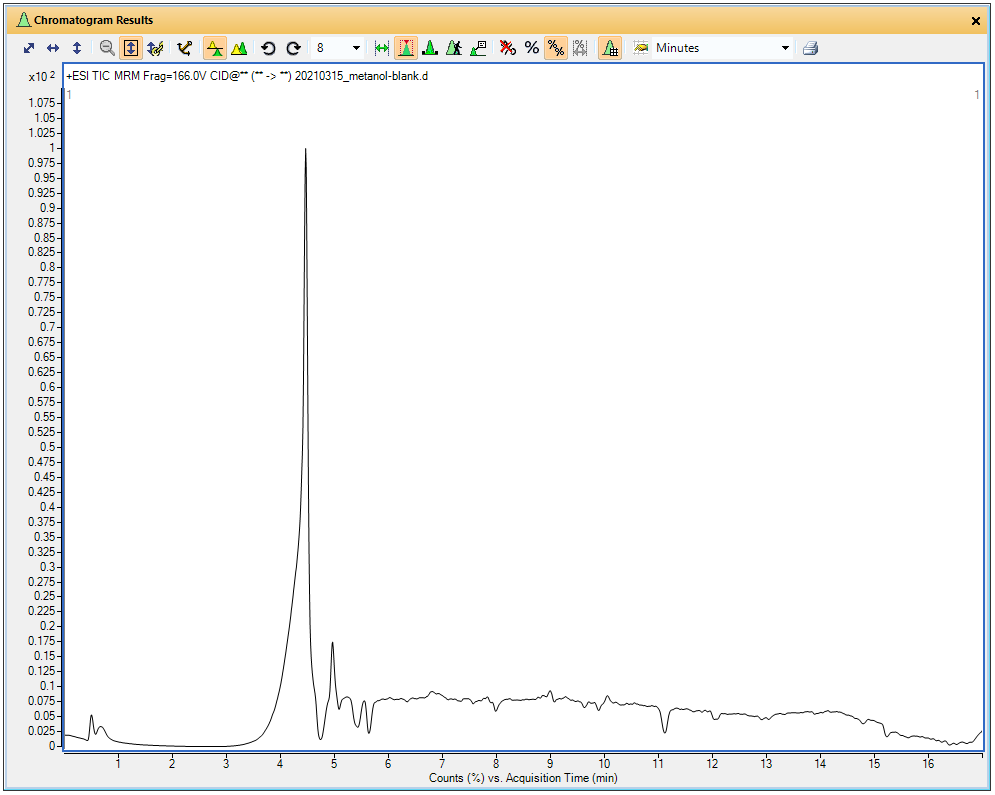

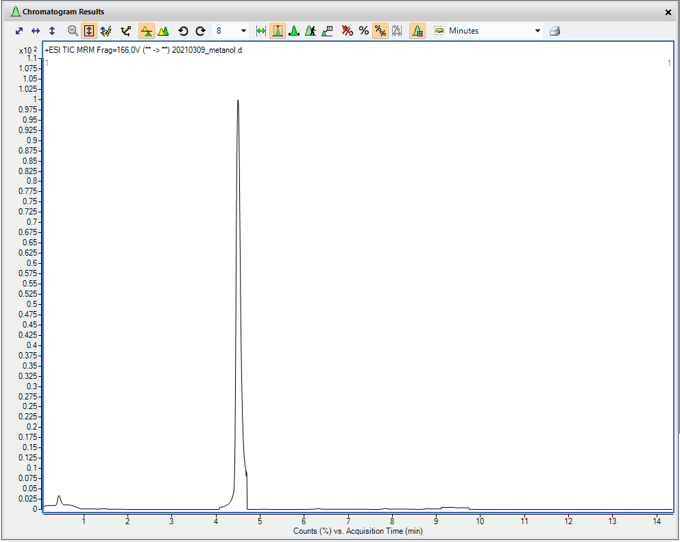

The title is ambitious, probably. I have a situation: In January 2021 I was transferred to this equipment, because former analyst left a job that month. The problem is that in the past year this machine was heavily used in pesticides analysis, and now it is just impossible to get rid of several pesticides: foramsulfuron, fenuron, bifenazate, nicosulfuron, imazalil, and several others. I tried almost anything to clean the system. I have cleaned capillary and it goes well with autotune. Cleaned column with any variant described in literature. Cleaned system with warm water (70 - 80 C) without column and flow 5 mL/min. Many other things, but those guys just stays in chromatogram. It is indicative, and you can see in TIC picture, that my problems are strict between 4 and 5th min, there are just a few latter on. Please help :)

I can't open the images here at work, but if these are making defined peaks then it means the contamination is prior to the column, or the column itself. If you use another column do you get the same contaminates showing up?
If yes, then from the needle to the column would be the problem. I just started using a similar instrument so I am not completely familiar with them yet, but it sounds like maybe the rotor of the switching valve in the autosampler could be contaminated and needs to be replaced.

Thanks guys! However, I haven't moved much farther, besides my personal opinion that there is something fishy with entire system :) Seriously now, I flushed system with hot water, collected efluent and then prepared with SPE like pesticides in water analysis, then analyzed on the 1200 / 6410 QQQ system, the system routinely used for pesticides in water analysis, and there was nothing at all. I have expected mere qualitative peaks, just a sign that something leaks from somewhere, but nothing. Then I have changed current method on the 6495 from dMRM to MRM and used only foramsulfuron transitions and parameters from the Agilent pesticides database. There are other bodies, but foramsulfuron is the most persistent one I think. The sample is blank - methanol, and the spectrum is unsolved mystery.

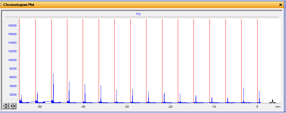

Cannot more agree with you, the 6495 is super sensitive MS/MS, I was so excited when I started working with him in Dec 2020. However, it's perfection causes limitations in analytical lab when routinely dealing with multiresidue methods. Leftovers at system level are just disturbing. It could be easy to ignore if they are as constant noise, but it's more like random generator... The chrom comparison below shows segment of 30 short runs with 100% ACN. The most abounded peak is, you guessing, foramsulfuron.
