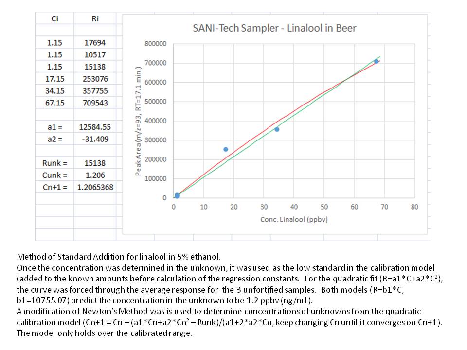

I ran 3 unspiked samples (a 5% ethanol-based solution) and 3 standards (same beer fortified with 16, 33, and 66 ppbv [ng/mL] linalool). 6 samples total. The results are summarized in the graphic:
https://i.postimg.cc/9MqG2sk2/Linalool- ... phic-I.jpg
I did have to sort the TIC by m/z=93 to see a signal for linalool that I could integrate in the unfortified samples. The concentration is low in this sample.
If you don't want to buy some other type of sampling devices, you can perhaps get by less expensively using this type of gizmo. It worked surprisingly well. I was able to determine ~1 ppbv (ng/mL) of linalool in my sample. I don't see a reason that it wouldn't work for sampling the headspace as well. It's like a big SPME fiber. It was surprisingly easy to condition the silicone tubing to be substantially free from volatile materials.
