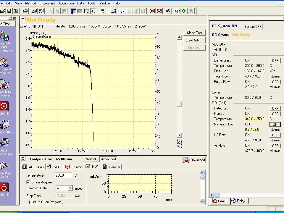

So Greg and I put the FID up to 450'C and have left it to bake for an hour or so now. There was a predictable rise in baseline of 150,000 uV, then a fall, slight rise and a fall again. Right now, it's still on it's way down, but slowly.
The spike and hike was when we set the make-up gas from 28 ml/min to 0.
The next step will be to drop it to 250'C (normal conditions for my analysis of essential oils) and see if it changes again with the oven program.

Okay, so here's what happens when the temp was dropped back to 250'C.

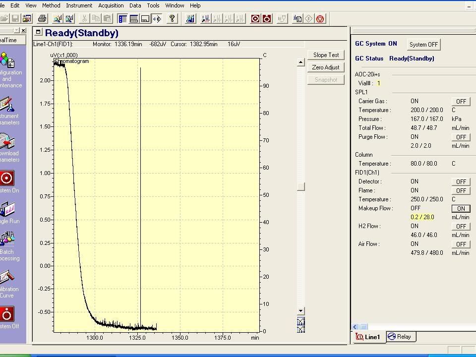

It has since started to level off around -600 uV. Once we have a fairly flat baseline I'll go through a normal oven cycle to check what's going on. Remember, it is a brand new GC which has never been used prior.
EDIT:
So this is what it looks like just prior to the standard 80-180 oven run.

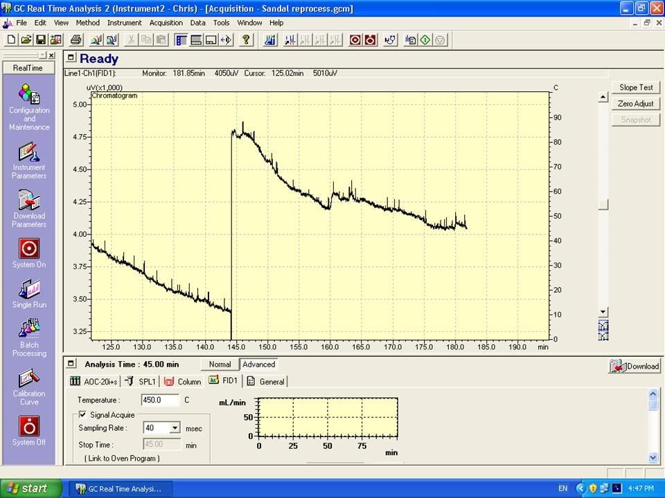

And this is what happens when you cool it from 450'C back to 250'C, then after a while, the FID was sent back to 450'C.
So it's clearly something to do with the FID. The baseline is exceptionally noisy, but there cannot be anything wrong with it - it's a brand new GC, straight from the box!
The column was an old one, so contamination of the FID may have occurred. There is still a possibility that the H2 and/or cyllinder was badly contaminated, but we'll cross that bridge when we get to it.
