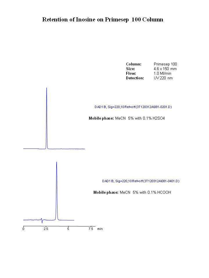

Here is retention of inosine on Primesep 100 column with sulfuric and formic acids in the mobile phase. Ion-exchange is much weaker than for adenosine (if you can even call it "ion-exchange"):

Hi Vlad,
this chromatogram "say" that the Inosine retention dosen't change whit cation exchange column from C18 column? Right?
For analyze Inosine I think that I'd must work with high pH mobile phase on polyvinil matrix. What you think?
