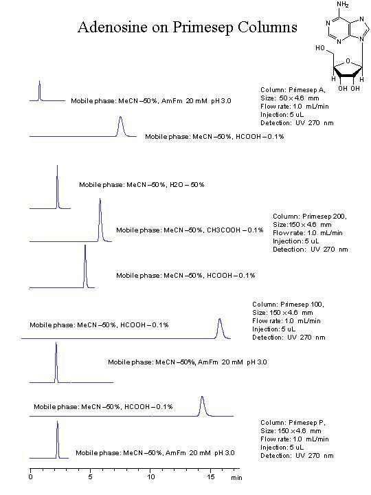

found old applications for adenosine in RP/cation-exchange mode. You can see how by changing strength of ionic intercation you can increase retention time:
You can also increase retention by reducing amount of ACN from 50% to 5-10%. Retention is controlled by both amount of ACN (RP) and amount of ions/pH (cation-exchange)

Oooh thank you Vlad! Thank you very much for your post.
Then... to observe this image carry me to think that the best compromise to peak shape and retention of adenosine is give from the use of Primesep 200 and acetic acid. It's right?
Another thing that I observe is that in all test you use 50% of MeCN in mobile phase. It's high as concentration. In my test if I use more than 10% of it Inosine is poor or not reteined really. This difference is by from cation exchange mode? Can I reproduce this condition on my cloumn/system? With this thing I would can to work in isocratic mode!

Inosine does not require pH 1 or 10 to be retained by ion-exchange mechanism. How would you explain retention on mixed-mode if it is not ionized? As you can see from my chromatograms you have cation-exchange even at pH 3 and 4 on mixed-mode cation-exchange column with plenty of retention (K'>20 in some chromatograms). Less ions, higher pH - more retention. Mixed-mode basically mimics ion-pairing chromatography. Also in mixed-mode you have synergy of two mechanism.

I think that when you have two interactions you enhance each of interactions by having a second one, that is why for example if you have hydrophilic molecule with weak basic group you still can control retention by amount of ACN, pH and amount of buffer. You can run hydrophilic basic compound on RP, and have it close to void even at very low organic, when you switch to RP/cation-exchange you will see effect of ACN even going from 30% to 20%. How would you explain drastic increase of retention for adenosine on chromatograms above, when we simply changed pH and amount of ions in the mobile phase? retention increased several folds for the strongest column.
You are saying that you need to be at pH 1 or 10 to have ion exchange and my example says that you don't.
In mixed-mode chromatography 1+1 is never 2, it can be 3, 4 or any other number (I am talking about strength of interactions)

If the most basic pKa is 4 for adenosine, retention at pH 4 should be less than at pH 3 and this is not the case.
