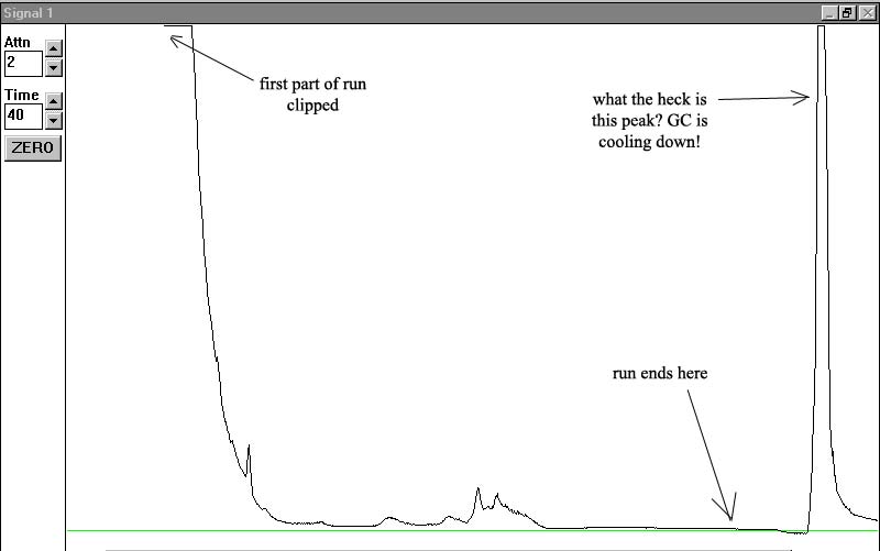

I'm not sure what causes the lack of repeatability, all of our injections from day 1 last week showed pretty sharp peaks. I wonder if injection technique is to blame.
for all but the last run i drew 1 uL into the syringe and injected it. for the last run above run, I drew in 5 uL, and injected it from 5 down to 4 uL. in all cases i washed the syringe with at least three full 5uL shots of pure heptane immediately after injecting.
I guess my major questions are:
1) any clue as to why am i seeing such lack of repeatability?
2) looking at the 'good' chromatograph above, would you say the column seems to be functional at least?
3) how can i reduce the solvent tailing? replace the guard column and/or clip a meter off the front of the actual column?
4) last night i 'baked' my column at 350C for an hour (sorry bruce!, i started right before your post, and i figured 350C isnt too hot). over the baking time, the high temperature baseline decreased pretty steadily. This morning i replaced the injector septa, and then checked my carrier gas flowrate. The flowrate had substantially decreased. Before we were using 6-8 psi on the EPC to get 3 mL/min carrier gas flow. I had to bump it up to over 14 psi to get 3 mL/ minute this morning! Does that tell us anything about the condition of the column?
5) what is the odd peak in the last chromatagraph above. This is well after the run is over when the GC is cooling down. Again, does it tell us anything about the condition of the column?
thanks everybody for all your advice!
this is very confusing!

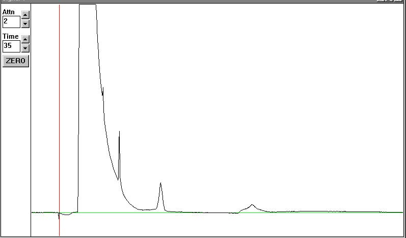

i took apart the inlet, there was a decent-sized chunk of septa lodged in the top of the column.
we are running heptane blanks right now,first run showed some vaporization of some heavy components similar to what we would expect with our standards. Second run was pretty flat. Initial solvent peak is a lot sharper, I'm hoping were in the clear, and it was a valuable learning experience!
The Sigma-Aldrich product manager indicated that he often sees large, elevated baselines with inexperienced biodiesel producers. This can be attributed to two sources:
