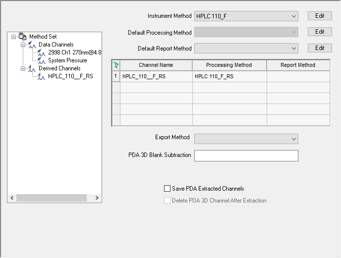

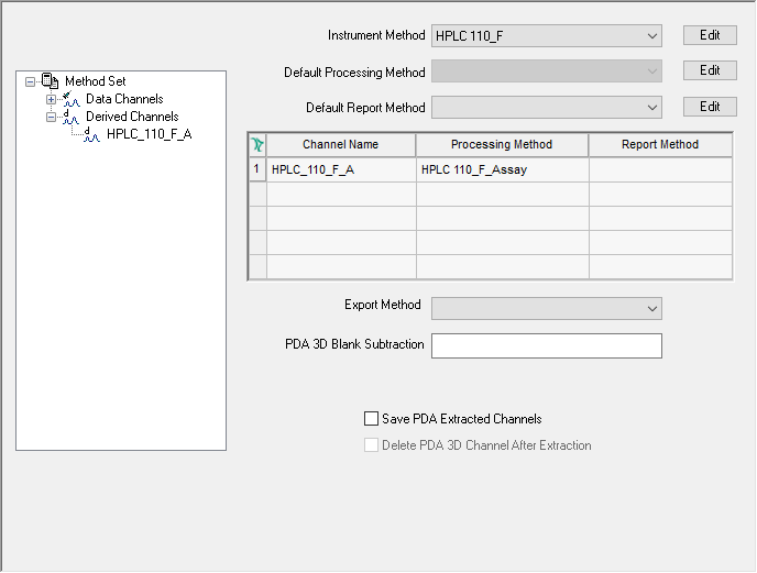

Method Set Assay+RS (HPLC 100_F_MG): Image
Method Set Assay (HPLC 110_F_A_MG): Image
Method Set RS (HPLC 110_F_RS_MG): Image

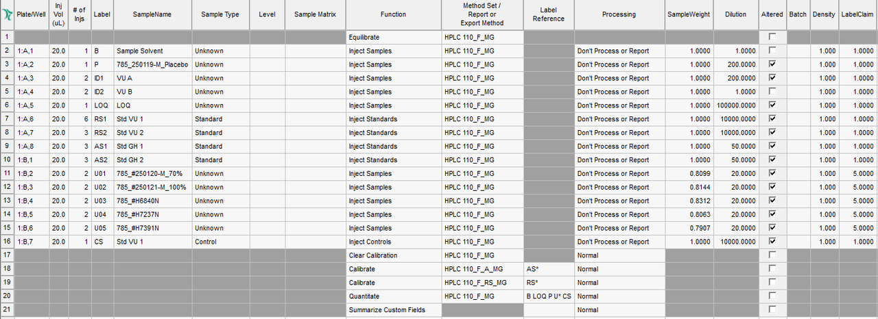

Sample Set: Image

Hi - thank you for replying as well and sorry for the inconvenience.
Unfortunally it is impossible to change the Sample Set's characteristics, as it is strongly connected to the SOP. As you an see (hopefully) in the sample set, we inject 9 RS Standards, following by 6 Assay Standards and having samples as 'Unknown'. After 12 Samples injections the control standard comes..
All the other custom fields functioning except the 'AVE' one..
Sample Set:https://ibb.co/W4f0R23W
Method Set Assay+RS (HPLC 100_F_MG): https://ibb.co/TM8WMzhz
Method Set Assay (HPLC 110_F_A_MG): https://ibb.co/xtDsL6jV
Method Set RS (HPLC 110_F_RS_MG): https://ibb.co/dsCKLDTs
