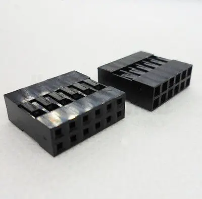

OK- the 19242-60500 cable plugs into the "Instrument Network Out" socket on the top right side of the instrument, under the top cover on the extreme right of the top of the 5890. It terminates with a 2 x 6 connector, something like this: Image Top, left to right, facing the connector: red, empty, green, brown, blue, empty. Bottom row entirely empty.
The cable in turn terminates in a DB-25; there are only four pins. The male pins, facing the connector, from left to right, are 1 (brown), 2 (blue), 3 (red), and 7 (green). I put in a connector to which I could solder wires, and soldered in three: 2, 3, and 7. Those three wires (bell wire or something like that from Home Depot) gets soldered into a female DB-9 connector, as per my previous post:

Where can one source these connectors?
Is it certain that they're 12-pin Dupont headers, and not something proprietary?
  • Image
